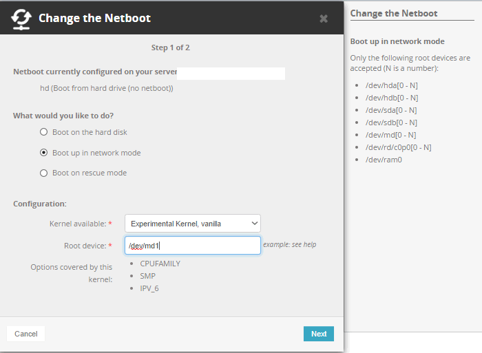

    Maybe useful
    https://www.ovh.co.uk/dedicated_servers/netboot.xml
    this is what i see on OVH MC-32 server a 4.9.13 Kernel vanilla i assume is non-GRSec based
    i am using mdraid on /dev/md1
    confirm and reboot server
    uname -r
    4.9.13-xxxx-std-ipv6-64

    @eva2000 booting netboot with the experimental kernel doesn't work. Tried it and it faulted my NVMe box.

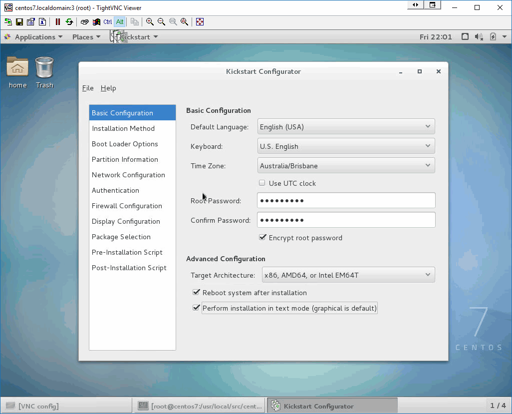

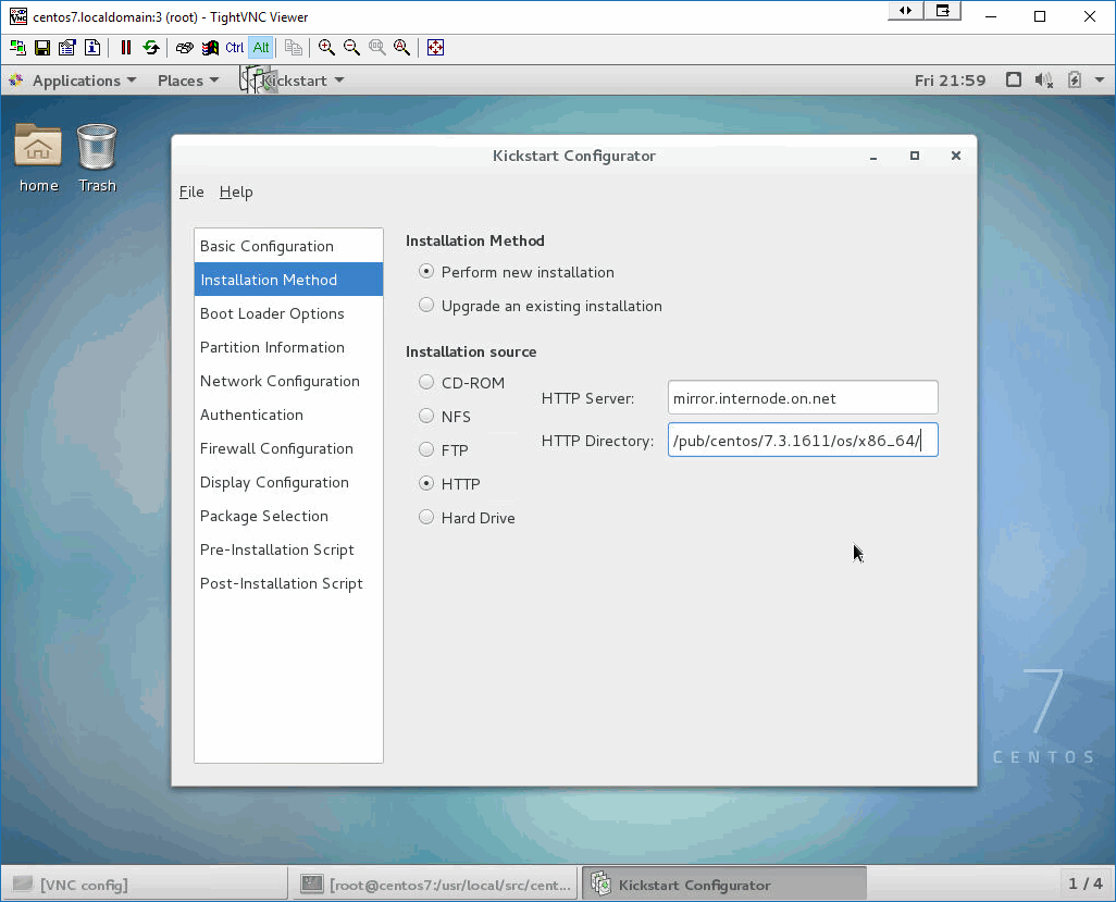

    I am curious if I can setup custom kernel with NVMe added support via CentOS Kickstart file based install.
    Testing out CentOS 7 with VNC setup for gui access https://community.centminmod.com/th...ll-on-virtualbox-guest-server.730/#post-47746 so can use gui based system-config-kickstart to generate kickstart file on OVH as OVH doesn't have the default kickstart file that is created normally on CentOS installs at /root/anaconda-ks.cfg
    testing on local virtualbox before trying on OVH
