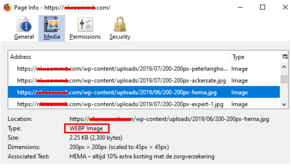

    @fabianski and @eva2000 I took all steps, but I won't purse out WebP images.
    fabianski, thanks for sharing, noticed a little difference it the setup of the SatelliteWP/rocket-nginx setup as you have it on domain level and not on the nginx level. The rest is almost the same, final result is that my config is the same as yours.
    But still pulling out my gray hears, don't know what to do to get it working. I don't use the addon Nginx Serving WebP Images Conditionally Demo, but the plugin WebP Express because it does the same, only has the advantage that it converts on the fly when uploading a new image.
    With that plugin WebP Express and without wp-rockt all was fine.

    Got the issue with WebP Working, placed this domain behind a Cloudflare PRO Plan + some extra paid services and it worked.
    I even got the headers of NGINX.....chache=YES (can't remember it exactly) and was happy with the result and made a backup and afterwards started the server again. After a while I did the check for the headers again, and, yep no more headers. Installed the SatelliteWP/rocket-nginx again on the domain but what I tried, the headers didn't show up anymore.
    After that I noticed that WebP worked I started to tune Cloudflare and the wp-rocket / autopimizer pluigins. Noticed that I still had troubles with the Lazy Load on the slider of the site, so I have to replace the original that comes with the theme with Slider 3 or something like that.
