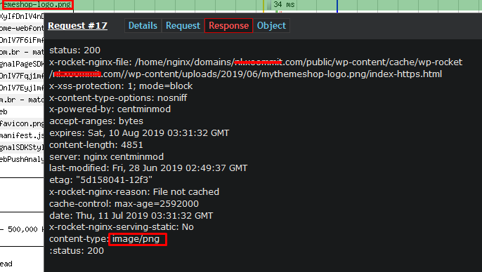

    Yep Wp Rocket... My idea of today. Got a specail offer with a discount of 25% for the infinify one. Spent $186.75 and followed the steps above.
    Loved it at first but a better look and all WebP, the WepP Express that worked before, it's simply gone.
    Placed a backup and on each step verified the existens of our WebP images, well they disapear at the moment that you install WP Rocket.
    No more WebP images on my page.
    They want you to install imagify to get support for WebP, but we have our whitelisted WebPExpress.
    I installed it, the plugin imagify and disabled all options except to display WebP images, but nothing seems to work. Got the API key and some credits. (hmm, 25MB/month free to optimize) --> WebPExpress does it for free.
    @eva2000 I need some help here, it's a little unfair of WP-Rocket. I disabled the autoproction in the conf.ssl, the wpinclude but on CMM it is a no go.
    But sadly as I was when I checked webpagetest.org. Our beautiful WebPExpress is with WP Rocket a no go.

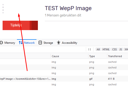

  17. EckyBrazzz
    913
    189
    +360
    5:50 AM
    Not a singel PNG or JPG image shows up. On the red arrow should be the erison logo Project_CMM_7272.png
