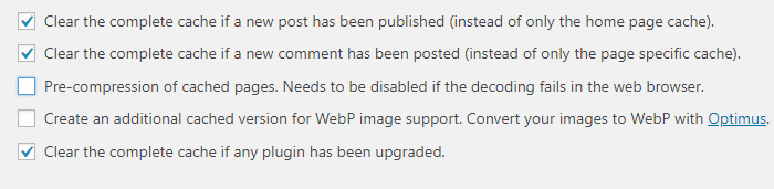

    I must be doing something wrong, I copy & pasted the code you posted, changed HTTPS to HTTP and still getting gravatars from their end, hmm..
    Screenshot
    And also disabled the pre-compression you mentioned a couple of mins ago
    2:55 AM
    did you uncheck pre-compression of cached pages and save the cache enabler settings
    sub_filter only works for wordpress with cache enabler when pre-compression is disabled

    Yes, looks exactly the same as the picture above
    2:55 AM
    try clearing browser cache, cache enabler cache and restart nginx + php-fpm
    the configuration i suggested works on my test install as long as pre-compression is disabled in cache enabler
