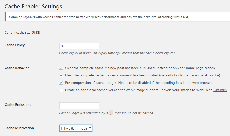

    KeyCDN Cacher Enabler
    KeyCDN Cacher Enabler is the selected default Wordpress caching setup which is an improved version of WP Super Cache for full page static WP caching. Need to enable some settings in Cache Enabler Settings area.
    Ideally set a Cache Expiry time in hours instead of 0

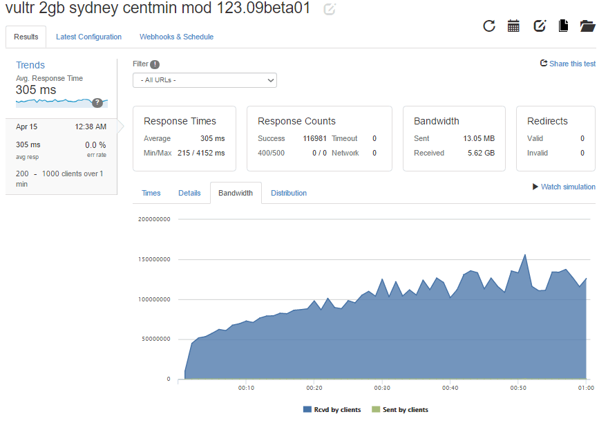

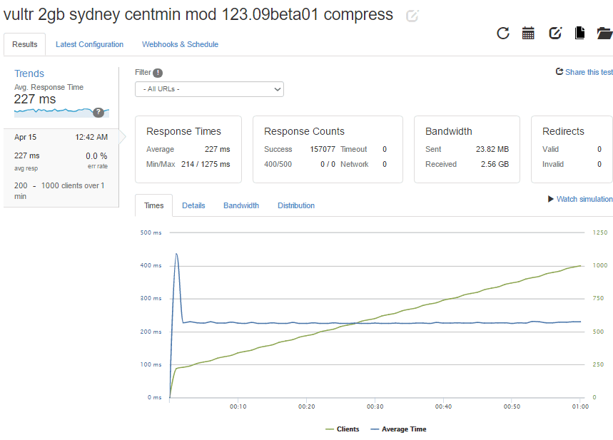

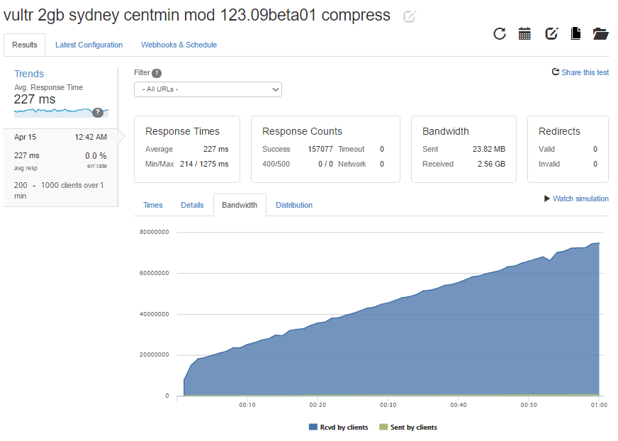

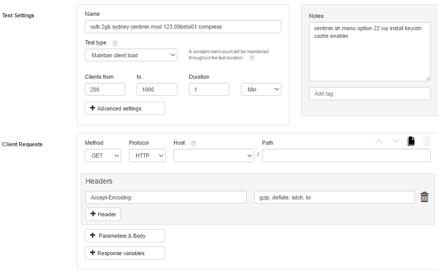

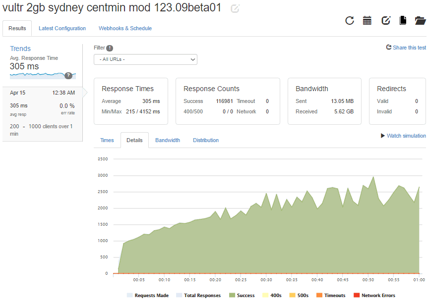

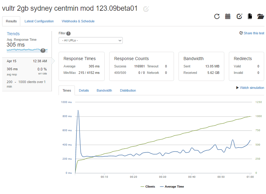

    Loader.io Test Paramenters
    Testing using Loader.io free plan for 'Maintained Client Load' testing between 200 to 1000 users for 1 minute.
    Testing 2 configurations:
    1. 1st config - where default is no gzip compressed http request headers so server serves non-compressed files.
    2. 2nd config - is with Accept-Encoding: gzip, deflate, sdch, br http request headers so server serves gzip or brotli compressed static files (usual default web browser behaviour).

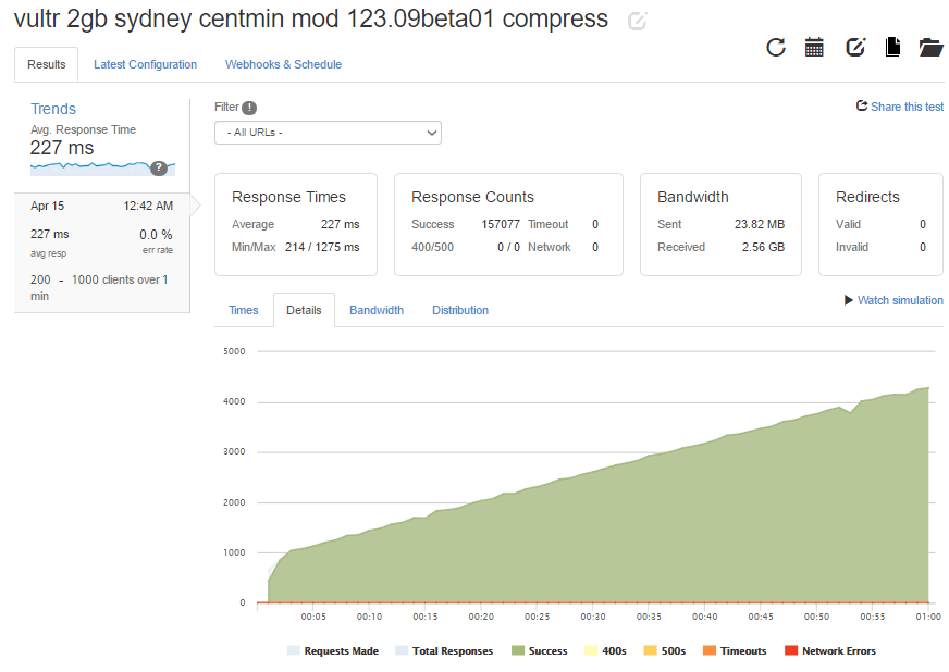

    Loader.io No compress

    Loader.io Compress

    Centmin Mod Nginx Access Log Stats
    Digging into Centmin Mod Nginx access log stats for test.domain.com site at /home/nginx/domains/test.domain.com/log/access.log filtered on loader.io user agent
    awk '{print $1, $6, $7, $9, $12}' /home/nginx/domains/test.domain.com/log/access.log | grep -w 'loader.io' | sort | uniq -c | sort -n
      11716 52.87.255.0 "GET / 200 "loader.io;49c41f4bef278734db99de15a3df47b7"

    Loader.io uses AWS infrastructure, so let's see where these test IPs come from geographically speaking
    awk '{print $1, $6, $7, $9, $12}' /home/nginx/domains/test.domain.com/log/access.log | grep -w 'loader.io' | sort | uniq -c | sort -n | awk '{print $2}' | while read i; do echo  -n "$i geolocation city: "; curl ipinfo.io/$i/city; done
    52.87.255.0 geolocation city: Ashburn
    52.91.128.14 geolocation city: Ashburn
    52.87.219.148 geolocation city: Ashburn
    54.208.68.192 geolocation city: Ashburn
    54.197.122.196 geolocation city: Ashburn
    52.86.198.91 geolocation city: Ashburn
    52.55.246.193 geolocation city: Ashburn
    54.85.214.144 geolocation city: Ashburn
    52.87.220.244 geolocation city: Ashburn
    54.85.128.114 geolocation city: Ashburn
    curl ipinfo.io/52.87.255.0
      "ip": "52.87.255.0",
      "hostname": "No Hostname",
      "city": "Ashburn",
      "region": "Virginia",
      "country": "US",
      "loc": "39.0481,-77.4728",
      "org": "AS14618 Amazon.com, Inc.",
      "postal": "20149"
    From Amazon AWS Ashburn datacenter which is US East coast so one of the furthest away locations for testing a Sydney, Austrlia VPS so hence the 200-300 ms response times from Loader.io testing.
