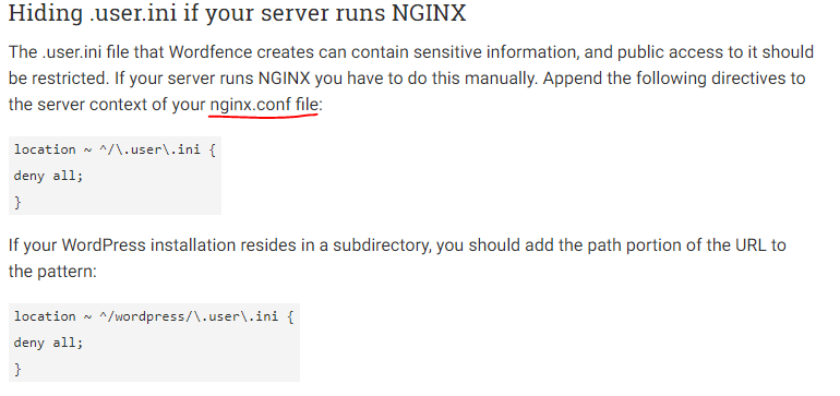

    Hi, I installed wordfence and they said that I need to hide user.ini if im running on NGINX: Hiding .user.ini if your server runs NGINX. Do I need to do that or is it preconfigured on CMM? If I need to configure it, where is the file located, and is there a way to do it globally for all installed vhosts?

    You will have to add it. Just copy and paste the corresponding code from below to nginx.conf

    Ok, so then it becomes global or do I have to user the 2nd option if I have multiple vhosts? How can I check if its working?
    Edit: Idk what I might have done wrong. I added it to this file, /usr/local/nginx/conf/nginx.conf, and added the code snippet right before the closing tag. But when I tried to restart nginx+php I got an error.

    you'd want to put in in your nginx domain vhost /usr/local/nginx/conf/conf.d/yourdomain.com.conf and/or /usr/local/nginx/conf/conf.d/yourdomain.com.ssl.conf
    though depending if you used centmin.sh menu option 22 to install wordpress, access to /.endingfile/directories with dot . prefix are denied by default via your include file created at /usr/local/nginx/conf/wpincludes/yourdomain.com/wpsecure_yourdomain.com.conf.
    or via include file /usr/local/nginx/conf/drop.conf via
    location ~ /\.          { access_log off; log_not_found off; deny all; }
    You can verify by manually accessing yourdomain.com/wordpress/.user.ini or yourdomain.com/.user.ini to see if you can access it
