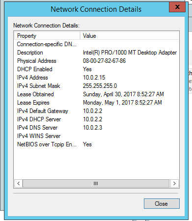

    i was able to get windows server 2012 working on vm, and access it from outside, and even using a domain,
    all i had to do was
    router
    port forward port80
    vm
    port forward port80
    i did those 4 steps for centos(in the vm) but for some reason i cant access it from outside
    im not sure why window server works in the vm, but centos wont work inside the vm

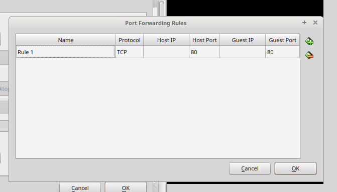

    then both the vm's have this settings in the vm machine network settings,
    and my router is port-forwarded, port 80
    i dont turn on both machines at the same time, i turn on either windows or centos,
    and windows works, i can access it from outside but not centos,
    maybe i will check my settings again,
    or maybe i will try another port other than the default 80
    but its strange

    i figured it out!!!!!!!!!!
    just had to port forward port 22 on my router and the vm!!!!!! and it works!!!!!
