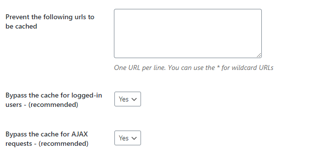

    As Cloudflare is pricing the Bypass Cache on Cookie out of reach (200USD / month), I am forced to try find another way. This plugin has the following options:
    I am wondering whether this would suffice for dynamic sites, such as Woocommerce.
    Additional page rules on Cloudflare costs 1 USD / month / page rule, so I am currently going this way with my try outs.
    45,991
    10,448
    +16,210
    6:25 AM
    see WP Cloudflare Super Page Cache
  9. tininho
    tininho Active Member
    131
    34
    May 22, 2019
    Nordic
    +95
    10:25 PM
    As these limitations are not mentioned or specified, I am afraid I must try :)
