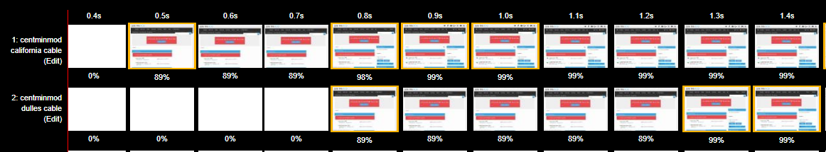

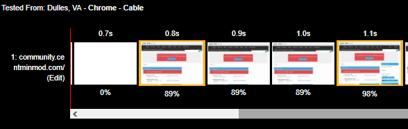

    This is forum index page on new Dulles WPT Agents Speedindex is around 600-1100ms faster than the old Dulles WPT Agents
    Need to test more to confirm it. But if others regularly test on WPT Dulles region, maybe retest now and see if numbers are better due to new Dulles WPT Agent architecture.

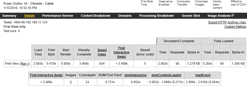

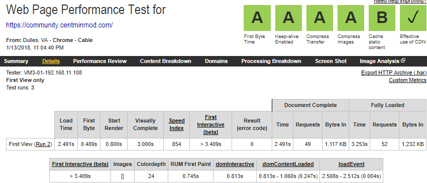

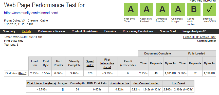

    Did a few retests on WPT Dulles region and definitely much faster now SpeedIndex previously was aroun 1400-1900ms and now consistently around 850ms

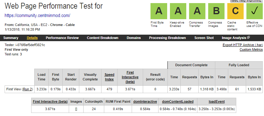

    SpeedIndex (perceived visual render time) is more inline with what I see with California WPT region which is faster as this forum's Linode VPS is in Fremont, California.
