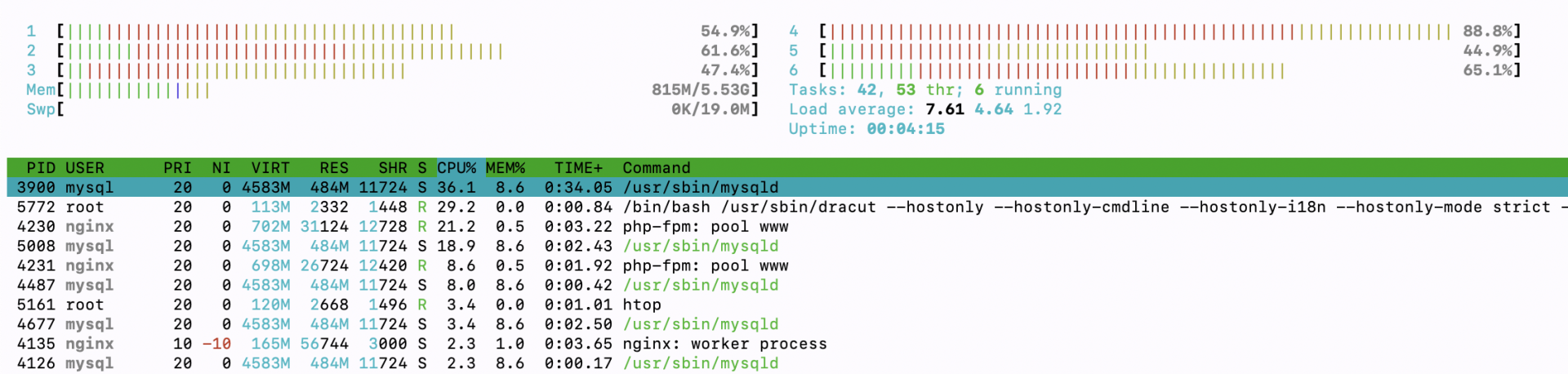

    Nginx 1.17.9
    MariaDB 10.3.22
    Similiar thread is here.
    I rebooted server and after that shutdown, make snapshot and then start server again. All through Upcloud server panel.
    I can not recompile nginx after that. Tried with
    MARCH_TARGETNATIVE='n'
    and after unsuccessful recompiling tried with MARCH_TARGETNATIVE='y' instead above one.
    Both recompiling faild.
    I also tried to swicth to gcc7, but nginx recompile failed too.
    Every time I shutdown/restart server, it happen again.
    I did switch servers provider, but that was two years ago. It all happened month or two ago.
    Could be gcc8, and pgo with php recompiling, I do not know.
    @eva2000 please help
    If gcc8 is mistake, I could switch to clang instead. Or to do something else?
