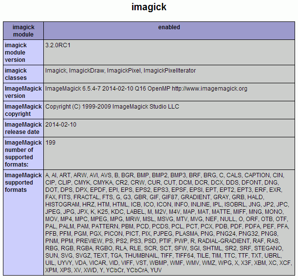

    But the 2 gallery addon requires Imagick to be able to rotate an image and other image manipulation.

    That is because the developer does not know/want to use the built-in GD options? XenForo devs use them without any issues to rotate the images with GD. Kier made a video about this.

    A few reasons for imagemagick are for wider file formats support and faster efficient processing (less memory consumed) when it comes to large images it seems Imagick vs GD Interesting the comments mention a faster drop in replacement for imagemagick called graphicsmagick GraphicsMagick Image Processing System Never heard of it before but used by Flickr and Etsy
    Graphicsmagick FAQ graphicsmagick.org/FAQ.html
    yum list graphicsmagick -q
    Available Packages
    GraphicsMagick.x86_64                                                            1.3.18-2.el6                                                             epel
    Gmagick for PHP PHP: Introduction - Manual
    Now I can sleep :sleep::sleep::sleep:

    I looked at that software a while ago, PECL gmagick never made it to stable since their release in 2009. Not really reassuring, IMO.
    59,592
    12,540
    +19,184
    3:13 AM
    yeah well gmagick is in RC2 PECL :: Package :: gmagick nothing wrong with that even imagick is only in RC1. But I guess pointless if no PHP apps specifically use the gmagick itself.

    well shared isn't needed as I do not intend to have every PHP extension needing an accompanying *.ini file to load the extension i.e. gd.ini file to load GD php extension. Remember Centmin Mod configuration is to cater to a much wider audience of users and with automation via scripting it is much easier not to have shared system which requires me to ensure the script manages and caters to every accompanying *.ini file.

    I only use stable versions, imagick does have a stable version.
    I see, I presume you deal with php.ini directly and add there all edits. Do you have a /etc/php.d equivalent? If you do, you should remove it because you don't use any shared libs. It eliminates confusion.
    59,592
    12,540
    +19,184
    3:13 AM
    yeah I only do have .ini for the main source compiled PHP extensions that require them
    php --ini
    Configuration File (php.ini) Path: /usr/local/lib
    Loaded Configuration File:         /usr/local/lib/php.ini
    Scan for additional .ini files in: /etc/centminmod/php.d
    Additional .ini files parsed:      /etc/centminmod/php.d/igbinary.ini,
    /etc/centminmod/php.d/imagick.ini,
    /etc/centminmod/php.d/memcache.ini,
    /etc/centminmod/php.d/memcached.ini,
    /etc/centminmod/php.d/zendopcache.ini

    @eva2000, but then you go against your own logic... either use shared libs or don't.
    Make up your mind! :D Here is a suggestion, use them everywhere for proper PHP standards.

    not really, i said I don't need it for every PHP extension, only ones that are source compiled separately themselves like php opcode cachers, memcache/memcached, igbinary extensions and most of them have a bunch of config options which warrant a separate .ini (besides just a line to load the extension) :)
