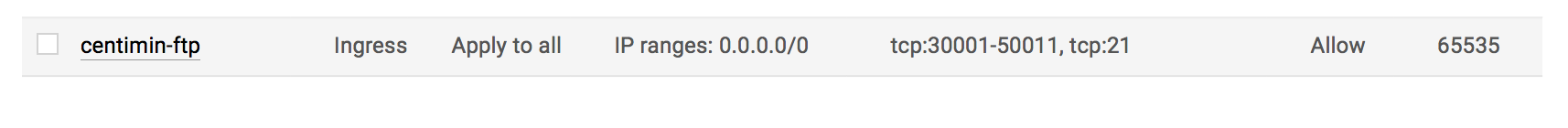

  9. rc112
    rc112 Member
    126
    14
    Sep 22, 2017
    +15
    11:34 AM
    Hi @bruno I got the same problem and have the firewall configured as below. Is it correct? Because I still got problem.
