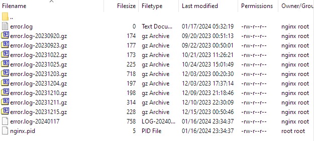

    Centmin Mod Log Files
    tail -10 /usr/local/nginx/logs/error.log
    is incorrect https://files.catbox.moe/8s8zbq.jpg. It's similar for most of the log files listed there.
    error.log-20240117 only has warnings about the "listen ... http2" directive is deprecated, use the "http2" directive instead.

    error.log is 0 bytes for my forum. The real log is "error.log-20240117" and contains some favicon errors which seems odd since Xenforo should be loading those from its db:
