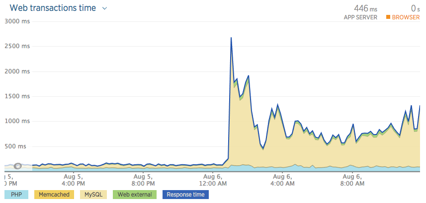

    Over the past two weeks, I've had three incidents (the third is currently ongoing) with suddenly slow database performance.
    The issue is not consistent, but when it does appear, it always begins shortly after 1:00am local (server) time. There is nothing scheduled at this time of day (backups, etc.) that I am aware of which would cause the issue.
    Here is what the incident looks like in NewRelic. As you can see, there is a drastic increase in MySQL's contribution to the overall web transaction time:

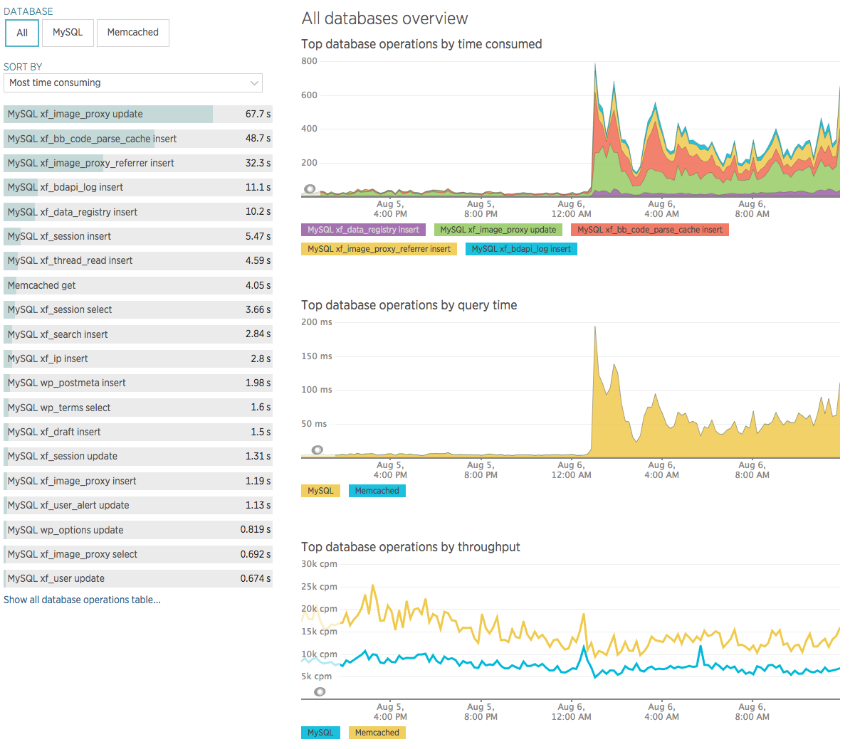

    Taking a closer look at the database activity report in NewRelic, unfortunately, does not offer any more clues. All of the tracked queries seem to have become "slow", with no particular outliers:

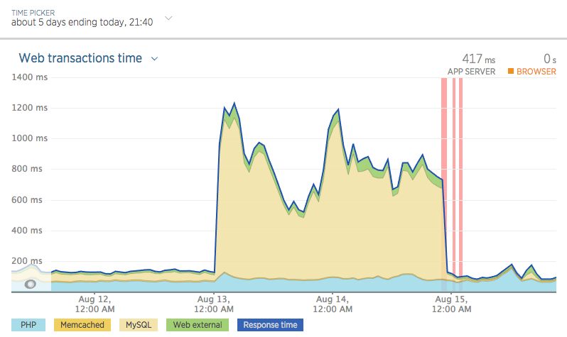

    For anyone curious, here's how the New Relic graphs changed...
    Thanks again, @Matt! I would strongly recommend his services to anyone who needs an extra bit of help. :)
