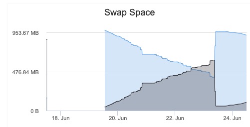

    Swap usage over 24 hours. You can see where the swap got to after a few days to the left, then I rebooted the server.

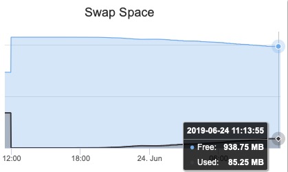

    Same server over 4 days:
    Another server over 4 days:

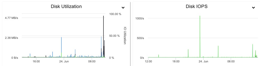

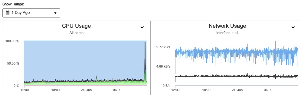

    The high CPU/Disk usage to the right of these graphs is from recompiling PHP to use version 7.3.5. It's the only software that isn't the latest version. I don't think it's the issue though.
    Screenshot 2019-06-24 at 11.52.25 am.jpg Screenshot 2019-06-24 at 11.51.35 am.jpg

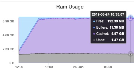

    Memory usage:

    08:40:01 AM     all      2.91      0.00      7.38      0.03      0.02     89.66
    08:45:01 AM     all      2.97      0.00      7.50      0.02      0.02     89.49
    08:50:01 AM     all      2.79      0.00      7.11      0.02      0.02     90.06
    08:55:01 AM     all      3.06      0.00      7.74      0.02      0.02     89.16
    09:00:02 AM     all      2.76      0.00      6.91      0.02      0.03     90.28
    09:05:01 AM     all      3.44      0.00      8.65      0.02      0.03     87.86
    09:10:01 AM     all      2.78      0.00      7.04      0.04      0.02     90.12
    09:15:01 AM     all      2.89      0.00      7.32      0.02      0.02     89.74
    09:20:01 AM     all      2.79      0.00      7.11      0.02      0.02     90.06
    09:25:01 AM     all      3.03      0.00      7.65      0.03      0.02     89.26
    09:30:01 AM     all      2.88      0.00      7.25      0.04      0.02     89.81
    09:35:01 AM     all      3.16      0.00      8.03      0.03      0.02     88.76
    09:40:01 AM     all      3.05      0.00      7.62      0.02      0.02     89.29
    09:45:01 AM     all      2.93      0.00      7.45      0.02      0.02     89.58
    09:50:01 AM     all      2.93      0.00      7.45      0.03      0.02     89.58
    09:55:01 AM     all      3.06      0.00      7.96      0.02      0.02     88.93
    10:00:01 AM     all      2.88      0.00      7.24      0.02      0.02     89.84
    10:05:01 AM     all      3.23      0.00      8.16      0.02      0.03     88.56
    10:10:01 AM     all      2.81      0.00      7.07      0.02      0.02     90.09
    10:15:01 AM     all      2.94      0.00      7.35      0.02      0.02     89.66
    10:20:01 AM     all      2.79      0.00      7.05      0.02      0.02     90.12
    10:25:01 AM     all      3.00      0.00      7.56      0.03      0.02     89.38
    10:30:01 AM     all      2.86      0.00      7.27      0.02      0.02     89.82
    10:35:01 AM     all      3.17      0.00      7.95      0.02      0.02     88.83
    10:40:01 AM     all      3.14      0.00      7.71      0.02      0.02     89.10
    Average:        all      2.98      0.00      7.10      0.02      0.02     89.87
    10:41:35 AM       LINUX RESTART
    10:45:01 AM     CPU     %user     %nice   %system   %iowait    %steal     %idle
    10:50:01 AM     all      2.86      0.00      6.57      0.03      0.02     90.52
    10:55:01 AM     all      2.98      0.00      6.94      0.02      0.02     90.03
    11:00:01 AM     all      3.02      0.00      6.92      0.02      0.02     90.01
    11:05:01 AM     all      3.40      0.00      7.76      0.02      0.03     88.80
    11:10:02 AM     all      2.96      0.00      6.88      0.02      0.02     90.12
    11:15:01 AM     all      3.10      0.00      6.96      0.02      0.02     89.90
    Average:        all      3.05      0.00      7.00      0.02      0.02     89.90
    11:15:27 AM       LINUX RESTART
    11:17:30 AM       LINUX RESTART
    11:17:38 AM     CPU     %user     %nice   %system   %iowait    %steal     %idle
    11:17:43 AM     all     28.08      0.00     13.61      0.00      0.06     58.25
    11:17:55 AM     all     19.94      0.00      5.39      0.10      0.04     74.52
    11:18:11 AM     all     27.47      0.00     14.50      0.07      0.07     57.89
    11:18:54 AM     all     18.93      0.00      7.74      0.51      0.04     72.78
    11:20:01 AM     all     11.74      0.00     12.18      0.34      0.04     75.70
    11:21:48 AM     all     26.00      0.00     22.81      0.11      0.08     51.00
    11:25:01 AM     all     69.72      0.00     25.41      0.09      0.12      4.65
    11:30:01 AM     all     20.21      0.00      7.50      0.09      0.04     72.16
    11:34:12 AM     all     47.09      0.00     23.19      0.03      0.10     29.59
    11:34:28 AM     all     13.82      0.00     25.00      0.16      0.08     60.94
    11:35:01 AM     all     19.20      0.00     10.40      0.21      0.07     70.12
    11:40:01 AM     all      7.35      0.00      7.46      0.03      0.04     85.11
    11:45:01 AM     all      2.07      0.00      3.93      0.01      0.01     93.97
    11:50:01 AM     all      3.00      0.00      5.76      0.02      0.02     91.21
    11:55:01 AM     all      3.21      0.00      6.13      0.01      0.02     90.63
    12:00:01 PM     all      3.24      0.00      6.33      0.02      0.02     90.40
    12:05:01 PM     all      3.41      0.00      6.86      0.02      0.02     89.69
    12:10:01 PM     all      2.96      0.00      6.03      0.02      0.02     90.97
    12:15:01 PM     all      3.25      0.00      6.53      0.02      0.02     90.18
    12:20:01 PM     all      2.78      0.00      5.73      0.02      0.01     91.46
    12:25:01 PM     all      3.04      0.00      6.35      0.02      0.02     90.58
    12:30:01 PM     all      2.91      0.00      6.11      0.01      0.01     90.96
    12:35:01 PM     all      2.96      0.00      6.37      0.02      0.02     90.64
    12:40:01 PM     all      2.86      0.00      6.15      0.02      0.02     90.96
    12:45:01 PM     all      3.10      0.00      6.61      0.02      0.02     90.26
    12:50:01 PM     all      2.81      0.00      5.97      0.01      0.02     91.19
    12:55:01 PM     all      2.87      0.00      6.21      0.02      0.02     90.89
    01:00:01 PM     all      2.86      0.00      6.14      0.01      0.01     90.97
    01:05:01 PM     all      3.25      0.00      6.90      0.01      0.02     89.82
    01:10:01 PM     all      2.61      0.00      5.67      0.01      0.02     91.69
    01:15:01 PM     all      3.02      0.00      6.47      0.02      0.01     90.48
    01:20:01 PM     all      2.82      0.00      6.11      0.02      0.02     91.04
    01:25:02 PM     all      2.83      0.00      6.21      0.02      0.01     90.92
    01:30:01 PM     all      2.78      0.00      6.12      0.02      0.01     91.08
    01:35:01 PM     all      3.20      0.00      6.78      0.01      0.02     89.97
    01:40:01 PM     all      2.86      0.00      6.22      0.02      0.02     90.88
    01:45:01 PM     all      3.13      0.00      6.75      0.02      0.02     90.08
    01:50:01 PM     all      2.68      0.00      6.08      0.02      0.02     91.20
    01:55:01 PM     all      3.00      0.00      6.50      0.01      0.02     90.47
    02:00:01 PM     all      2.85      0.00      6.11      0.01      0.02     91.01
    02:05:01 PM     all      3.29      0.00      7.17      0.02      0.02     89.51
    02:10:01 PM     all      2.74      0.00      5.99      0.02      0.02     91.24
    Average:        all      6.26      0.00      7.28      0.03      0.02     86.41

    top -bHn1 -w200
    top - 16:20:00 up 1 day,  4:24,  1 user,  load average: 0.50, 0.35, 0.33
    Threads: 164 total,   1 running, 163 sleeping,   0 stopped,   0 zombie
    %Cpu(s):  1.4 us,  2.8 sy,  0.0 ni, 95.8 id,  0.0 wa,  0.0 hi,  0.0 si,  0.0 st
    KiB Mem :  8008856 total,   236308 free,  1472920 used,  6299628 buff/cache
    KiB Swap:  1048572 total,  1025020 free,    23552 used.  6171576 avail Mem

    From cminfo top output not seeing nginx as a swap user there so probably it's a victim not a culprit of low memory free availability. Most likely it's MySQL itself given it's virtual memory size. I'd be tuning MySQL buffers to lower memory usage. But the current cminfo top shows no swapping to disk right now so probably not a good indicator.
    also suggests it's normal occurrence of swap as you're reaching low memory free availability free with high/low reported memory usage shows low stage you have 248MB free
    free -mtl
    Mem:           7821        1456         248          19        6115        6008
    Low:           7821        7572         248
    High:             0           0           0
    Swap:          1023          56         967
    Total:         8845        1512        1216
    sar -r output shows memory free can get down to 115,244 KB or 112.5MB with 6,871,768 KB or ~6.55GB in committed memory at 2:30:01 AM on June 24 so it's would be expected that swap would be avenue for other apps/processes fighting for memory availability when it gets that low
    02:15:01 PM kbmemfree kbmemused  %memused kbbuffers  kbcached  kbcommit   %commit  kbactive   kbinact   kbdirty
    02:20:01 AM    202916   7805940     97.47     11932     70088   6771340     74.76    690792    828088       176
    02:25:01 AM    182440   7826416     97.72     11692     68644   6771372     74.76    691916    825088       204
    02:30:01 AM    115244   7893612     98.56     11884     70180   6871768     75.87    765484    827260       160
    02:35:01 AM    160816   7848040     97.99     12040     68096   6805148     75.13    724492    824084       152
    02:40:01 AM    201464   7807392     97.48     11328     63380   6785212     74.91    694804    818400       148
    02:45:01 AM    197548   7811308     97.53     11552     63292   6771364     74.76    690000    819192       124
    02:50:01 AM    220572   7788284     97.25     11504     62528   6771340     74.76    689052    818620       180
    02:55:01 AM    221728   7787128     97.23     11700     62592   6775560     74.81    695176    815644       192
    03:00:01 AM    160600   7848256     97.99     11408     69932   6819508     75.29    702796    823336       180
    03:05:01 AM    161896   7846960     97.98     12376     74308   6805656     75.14    727012    824176       160
    03:10:01 AM    192268   7816588     97.60     12856     66456   6771872     74.77    693136    817512       188
    03:15:01 AM    155744   7853112     98.06     71876     91708   6771372     74.76    730208    867844       148
    03:20:01 AM    205064   7803792     97.44     64252     82856   6771372     74.76    728272    853456       172
    03:25:01 AM    201988   7806868     97.48     60788     75348   6771368     74.76    720208    850692       184
    03:30:02 AM    184568   7824288     97.70     54844     69968   6803456     75.11    715532    853824       208
    03:35:01 AM    237096   7771760     97.04     41748     68328   6771368     74.76    697588    847056       840
    03:40:01 AM    137588   7871268     98.28     39764     64196   6838936     75.51    760396    844056       140
    03:45:01 AM    179840   7829016     97.75     33096     65400   6771796     74.77    695436    837592        48
    03:50:01 AM    185920   7822936     97.68     24256     63468   6771368     74.76    694888    827116        48
    03:55:01 AM    174796   7834060     97.82     18544     64552   6771368     74.76    694684    822808       180
    04:00:01 AM    156888   7851968     98.04     13588     70808   6821980     75.32    707208    823656       136
    04:05:01 AM    228080   7780776     97.15     12024     71516   6771340     74.76    697652    820068       204
    currently no way to disable that though those logs get purged every 5 days. But pretty sure it isn't the cause of swapping.
    you can use cminfo top command via cronjob to record your usage if you want as the cminfo top output is saved to a log in /root/centminlogs/ directory so you can see your specific process and system usage.
    For CentOS 7, you can try changing in /etc/sysctl.d/101-sysctl.conf the vm.swappiness from 100-10 = swap to disk when 90% full memory
    vm.swappiness=10
    to swap to disk when 100-1 = 99% full memory
    vm.swappiness=1
    then for changes to take affect run
    sysctl --system

    Just wanted to update this ticket... It seems that using the ENABLEMOTD config has worked. The three servers I used configured are no longer using SWAP and there aren't thousands of centminlog files anymore. IF people are syncing servers via SSH with a service like Lsyncd and/or cluster/server monitoring services that use SSH, then you should set the centmin config with this:
    ENABLEMOTD='n'
    ENABLEMOTD_CSFMSG='n'
    ENABLEMOTD_LINKSMSG='n'
    Many thanks as ever for your detailed replies.

    The issue was happening on 4 VPS's using two vendors and a dedicated server with 32Gb memory.
    After over 24 hours the swap still isn't used. Fingers crossed.
