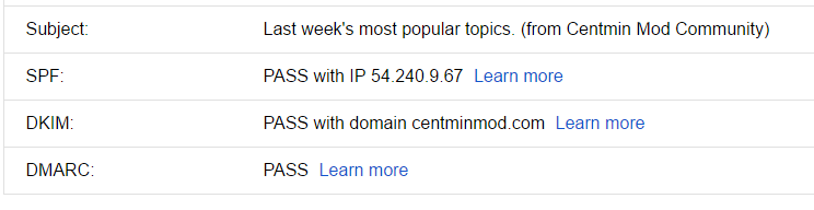

    Where is destination email hosted ? Gmail or Gsuite apps ? view email and view select 'Show Original' for email should give you something like
    status of your SPF, DKIM and DMARC records - depending on DNS provider can take while to update DNS
    various tools outlined at https://community.centminmod.com/th...ver-email-doesnt-end-up-in-spam-inboxes.6999/ to test validity of your SPF, DKIM and DMARC records and also test if your server IP address is blacklisted or domains listed in email are blacklisted.

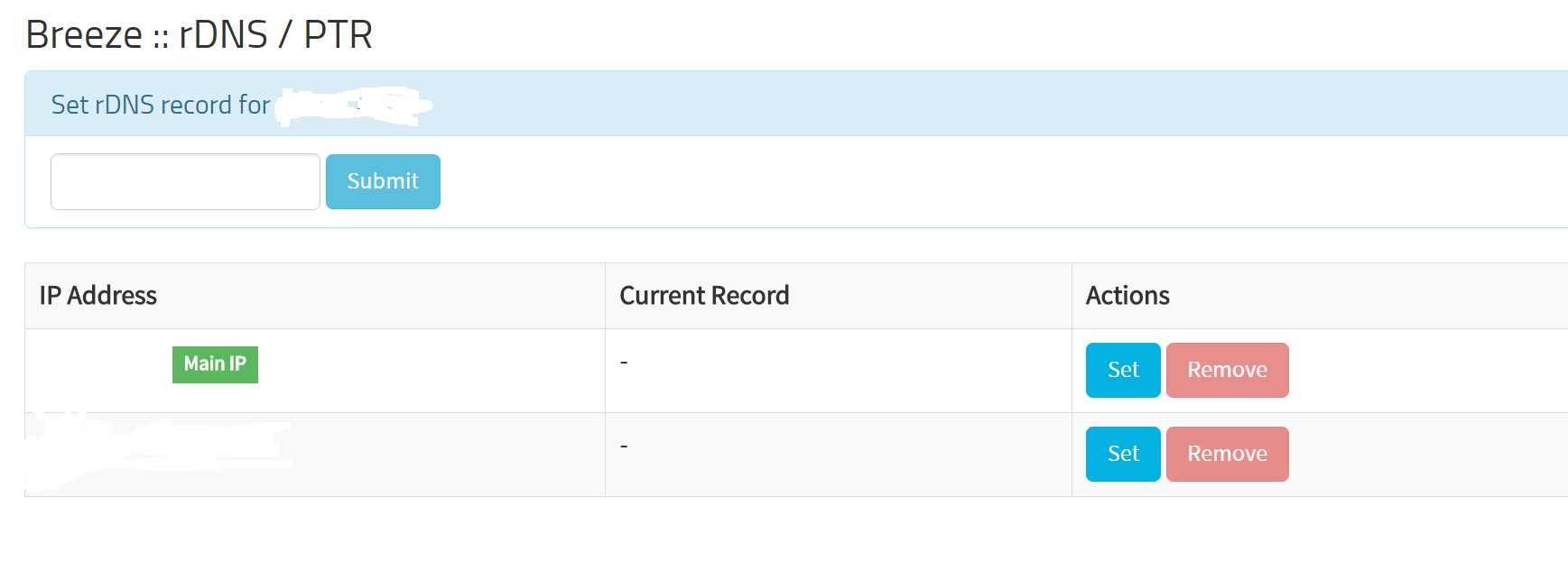

    @eva2000 yes they do allow me to submit a record. I just don't know what to put there. I will show you what they have:
    I just don't know what to put in the submit box?

    for main ip, you put your main hostname which would be same as hostname on order form and same as one setup in step 1 of getting started guide
    same one that is displayed from output of the command
    hostname
