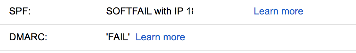

    Hi, thanks for your help. I think I set everything up properly now, exactly according to instructions. The emails are being sent now but still into spam inboxes and SPF, DMARC are failing according to gmail(even though I think I set it up properly). Really strange stuff.
    I followed the instructions EXACTLY and have SPF, DMARC and DKIM 2x for both domain.com and hostname.domain.com and contacted my host for the reverse ptr to hostname.domain.com yet it STILL doesn't work. This is extremely frustrating. I will spend some time learning about DNS myself I guess and try to fix it, and I'll post my fix here when I'm done. I have probably struggled to fix the DNS for 50+ hours of my life now, lol.

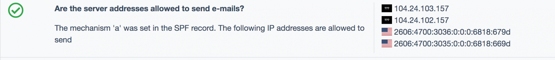

    Also, I had some breakthrough in my logic, I think the issue is CLOUDFLARE and not my DNS records. I found it out by running it through an SPF record analyzer.
    As you can see the spf record shows that for the mechanism a included in the record it refers to those IP addresses. However that is a cloudflare IP address, not my server IP. so it makes sense that the SPF is invalid. So, I guess when using cloudflare you have to include the server ip address into the SPF record. Will try that next.

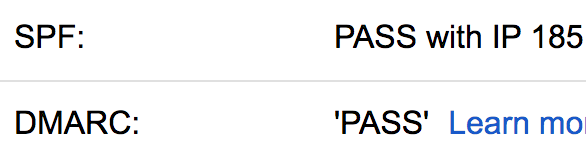

    And there we go folks.. All fixed. Honestly some rage but screw Cloudflare for making me waste so much of my time on this shit. It's not intuitive at all that the cloudflare A record which points to the actual server address would somehow be recognized as the cloudflare servers IP address just because they act as reverse proxy. It makes no sense.
    Maybe you should explain that to users on here in your DNS guide since it's very illogical(to me). Or maybe it's because I am using the host.domain.com A record with proxy option as well? Not sure.
