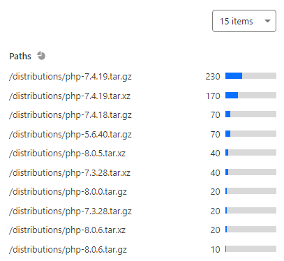

    Seem implementing this workaround ~26hrs ago, Cloudflare is reporting local PHP mirror download count of 690 downloads.
    Top 15 downloaded PHP versions from local Centmin Mod mirror
