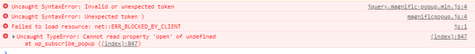

    I have several domains and one is hosted with centmindmod with wordpress. The domain is Melhor Cupom site do Brasil - Melhor Cupom site do Brasil and the problem is that the popups don´t work anymore with this domain like with Coupons Nederland -
    If you wan´t to close the page a popup should appear from mailchimp. Also if you click GET OFFER there should be an popuop but on my fresh and modified install it won´t work.
    I think this is a NGINX issue but I´m not sure about that.
    I hope that someone can give me a helping hand to resolve this issue because I really like the system.

    is javascript on 3rd party domains for popups or on your domain served javascript urls ? could be security headers
    x-xss-protection: 1; mode=block
    x-content-type-options: nosniff
    or could be wp rocket related and/or cloudflare i.e. cloudflare rocketloader https://support.cloudflare.com/hc/en-us/articles/200168056-What-does-Rocket-Loader-do-

    But the effect keeps the same. No popup. Also disable the minify options in CloudFlare.
    I did some testing with another panel namely ISPConfig with NGINX and did not have this problem, but I like to be able to compile to get some extra preformance.
    Btw I installed the wordpress with option 2 to create a new site.

    FYI seems you have some javascript errors in browser console display too
