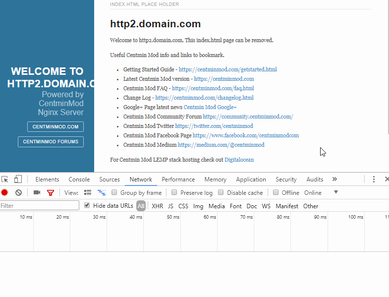

    @eva2000 How can we get this to work on all domains, not only just one.
    There are many files in domains that we want to have with Push Support like the image below (yours)
