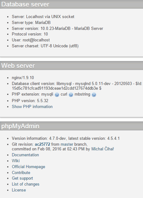

    The problem is the version of the phpmyadmin, previously I used phpmyadmin version 4.6.0-dev. I think the version have bugs with login session cookies.
    WhenI see @eva2000's screenshot above, he use phpmyadmin version 4.7.0-dev it was different with my phpmyadmin version. I do not know, maybe the developer recently made improvements from the previous version and update.
    I did uninstall and reinstall it, bingo!!, the problem was disapear and my phpmyadmin version now is 4.7.0-dev.
