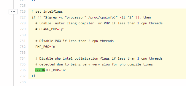

    Actually i put in place a work around for this back on June 23, 2018 https://github.com/centminmod/centm...d9d13b2#diff-01287bb69c66cf973b36ce5380d36a72 (listed in inc/php_configure.inc commit history logs)
    core-avx2 targets disable avx instructions in GCC 4.8.5
    gcc -c -Q -march=core-avx2 --help=target | egrep '\-mavx |\-mavx2 '
      -mavx                                 [disabled]
      -mavx2                                [disabled]
    but not with GCC 7.3.1 or 8.2.1
    /opt/rh/devtoolset-7/root/bin/gcc -c -Q -march=core-avx2 --help=target | egrep '\-mavx |\-mavx2 '
      -mavx                                 [enabled]
      -mavx2                                [enabled]
    /opt/rh/devtoolset-8/root/bin/gcc -c -Q -march=core-avx2 --help=target | egrep '\-mavx |\-mavx2 '
      -mavx                                 [enabled]
      -mavx2                                [enabled]
    workaround allows PHP uses higher version of GCC compiler than CentOS 7 system GCC 4.8.5 it works, but i see your PHP upgrade log GCC 4.8.5 system compiler was used.
    Do you have any persistent config file /etc/centminmod/custom_config.inc settings set which may disable my workarounds I wonder ? edit: i see you have alot of custom settings in https://gist.githubusercontent.com/...3f3a80756318032846a49fa8b4f3d1b/gistfile1.txt. I'd try an empty persistent config and see how PHP 7.3.2 compiles first to rule out your persistent config settings.
    One such setting is GCCINTEL_PHP='n', it defaults to GCCINTEL_PHP='y' by default in 123.09beta01 and only time it's disabled is if there is less than 2 cpu threads on the server from these lines https://github.com/centminmod/centminmod/blob/123.09beta01/inc/php_configure.inc#L726-L737
    It could be the last part if you are using Intel Skylake cpu with 1 cpu core VPS then GCCINTEL_PHP='n' is set and PHP never gets to use devtoolset provided higher GCC 7.3+ compiler versions and for PHP 7.3 means avx instructions are not enabled due to using core-avx2 targets. So possible fix is to add exception to that rule for less than 2 cpu cores to exclude PHP 7.3 from GCCINTEL_PHP='n' auto setup
    Another reason is if you set LOWMEM_INSTALL='y' which for low memory installs won't have enough memory on system for intel optimised PHP compilations so disables devtoolset GCC 7.3+ compilations and fallsback to system GCC 4.8.5 compiler and thus would have problems with PHP 7.3 required higher GCC versions
