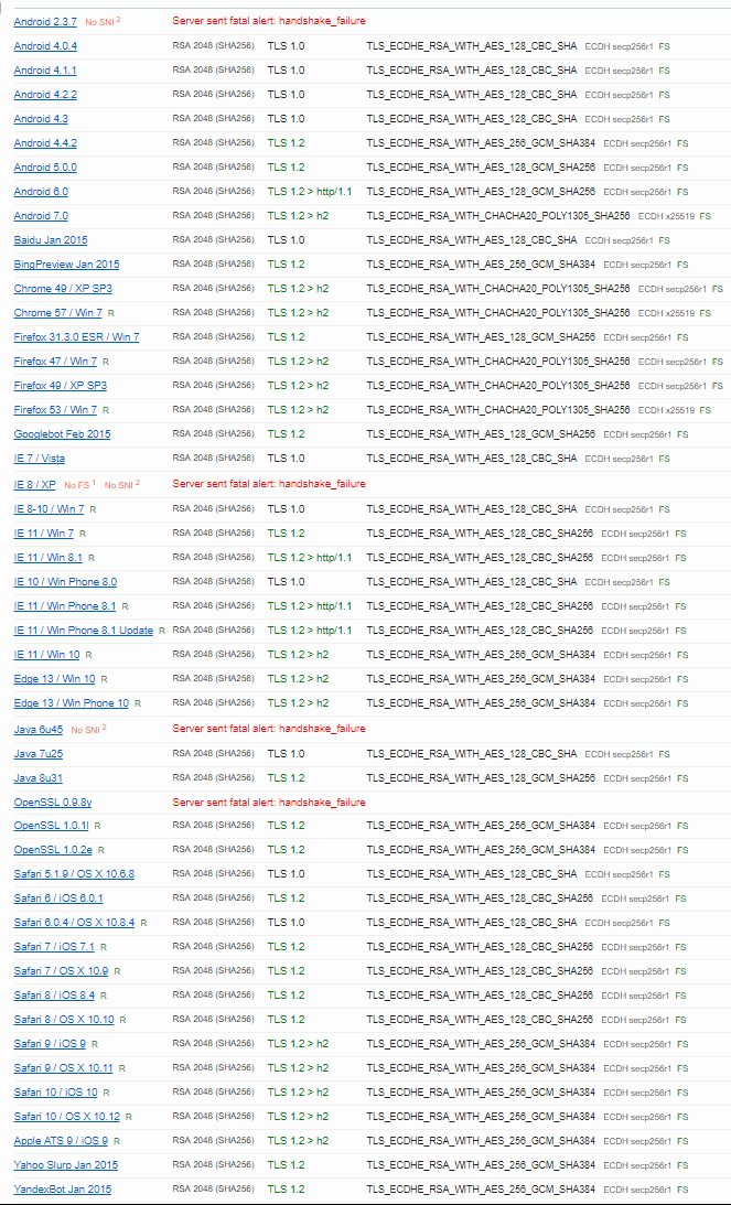

    which IE8 ? XP or Win7 ?
    openssl 1.1 disables 3DES ciphers now https://www.openssl.org/news/cl110.txt

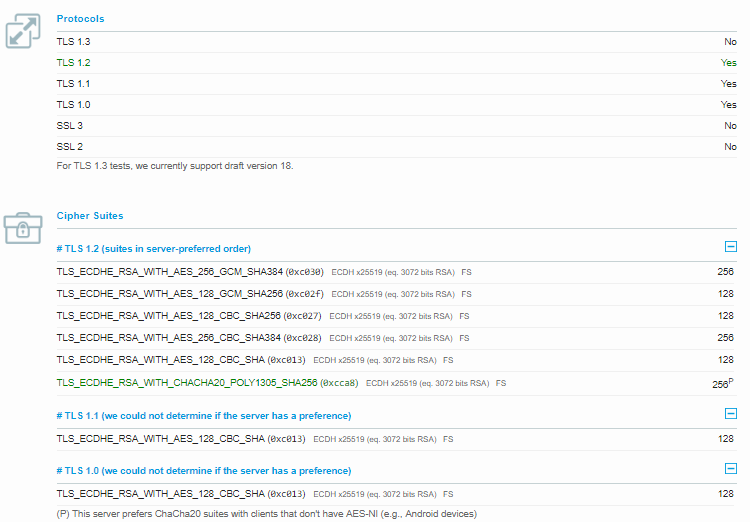

    yeah they did switch to boringssl hence, why centmin mod 123.09beta01 now disables cloudflare patch by default
    though it did patch for me a while back still with openssl for centmin mod nginx - haven't checked lately but should be fine as the patch is against nginx itself not openssl
    edit: nginx 1.13.4 + openssl 1.0.2l with cloudflare patch enabled doesn't seem to work as discussed above no chacha20 ciphers
    but centmin mod nginx 1.13.4 + openssl 1.1.0f + cloudflare patch shows chacha20 but that might be because openssl 1.1 has native chacha20 support :)
    Patching OpenSSL 1.1.0 branch
    Cloudflare Smart ChaCha20 patch
    https://community.centminmod.com/posts/35727/
    only support ChaCha20 if client's preferred cipher
    /usr/local/src/centminmod/patches/openssl/chacha20-smarter.patch
    patching file ssl/s3_lib.c
    patch unexpectedly ends in middle of line
    OpenSSL 1.1.0 branch Smart Chacha20 patched
    then wihtout cloudflare patch disabled + nginx 1.13.4 + openssl 1.1.0f
