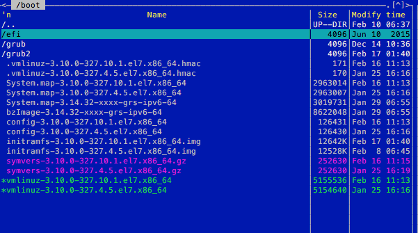

    It worked fine before the latest update (YUM) that I ran.. that was around the 16'th.. and look what the /boot directory shows
    All of a sudden it appears that OVH pushed out their GRS kernel... the others look like a default one (and what was there when I set it up) or did something that has resulted in it going back and using their custom crap.

    might want to ask OVH if that was something they pushed out themselves on latest yum update ?
    you can see using yum history command where transaction id is of id listed in yum history for around that date of yum update
    yum history
    yum history info transactionid

    OK, found the apparent reason that OVH forces you to use their custom kernel. The new 2016 server that I have uses a new network card that is NOT supported in the current CentOS kernels - and is in the custom one.
    03:00.0 Ethernet controller: Intel Corporation Ethernet Connection X552/X557-AT 10GBASE-T
    03:00.1 Ethernet controller: Intel Corporation Ethernet Connection X552/X557-AT 10GBASE-T
    So it doesn't look like I can go to the default anyway.. so will leave it as is.
