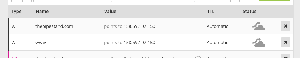

    And in CloudFlare DNS

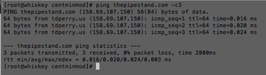

    Ping from the server trying this on

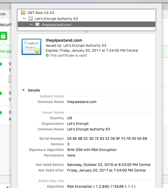

    Nope.. it happened before it existed.. this was a brand new domain (I'm rebranding pipejunkie.com).. and it WILL issue fine using acme.sh ;)

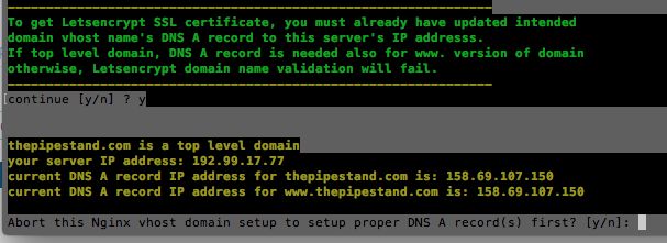

    1.21.6
    MariaDB 10.3.36
    OK.. I've wiped all the directories, removed the vhost definition and reran option 2 from CentMin... and here is what it shows when going to create a LetsEncrypt SSL cert.
    Sure does look like it's finding the A records for both the www and non-www domain.
    I don't know why it's prompting me to abort to set up a proper DNS A record when it's already showing it exists :banghead:
    59,718
    2:14 AM
    ok, checked, there's no check for that it asks if you want to abort whether or not the A DNS record exists or not. As it could be the end user has old outdated DNS A records etc. Centmin Mod isn't able to tell if the end user's desired DNS A records are the ones they want.
    Probably can add a check so if DNS A record is same as the server IP the user is running centmin.sh on.
    edit: updated 123.09beta01 for such a check now Beta Branch - update inc/nginx_addvhost.inc update DNS checks in 123.09beta01 | Centmin Mod Community :)
