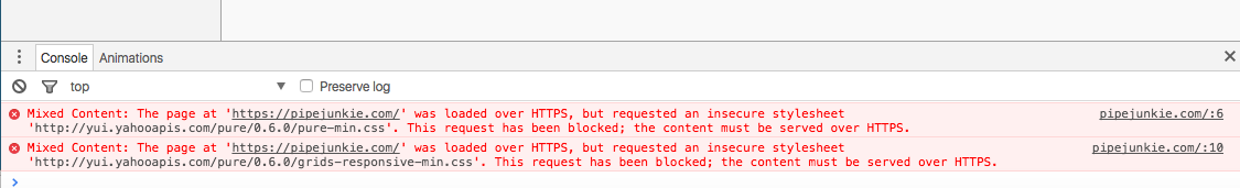

    As an aside... and related to the SSL setup - I get this error on my default vhost.
    Looks like it's serving the CSS from a static http: site instead of a general // call.
    EDIT:
    And it appears it's because that it's not served from a secure location as an option.
