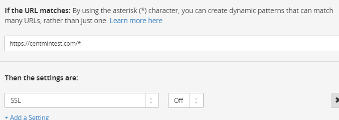

    Can't find what can cause that redirect as there is no related option and i don't have any page rule at all there....
    Ok i will let them know ....
    60,079
    12,578
    +19,232
    8:02 PM
    maybe a cloudflare page rule is needed to turn off their SSL if https version of site is accessed i.e.
    confirm with cloudflare though
