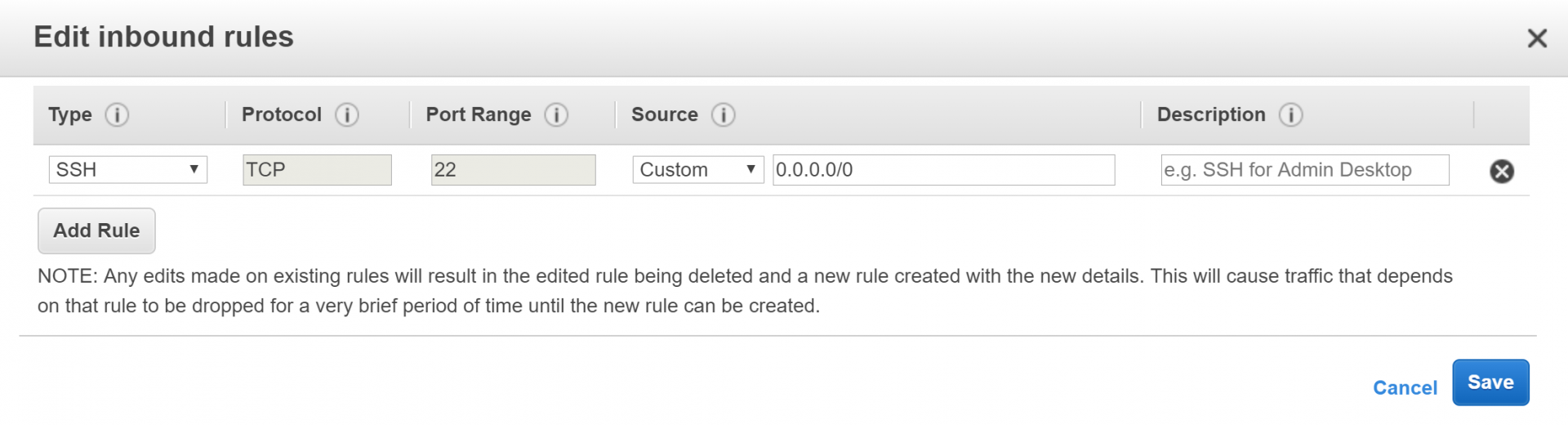

    Hi, so I booted up a fresh instance on EC2 and logged in via SSH, typed "sudo su" and copied over the one-line install script.
    When the script finished installing, Nginx dooes not exist. I tried running "nprestart" and got the following error:
    Restarting nginx (via systemctl):  Job for nginx.service failed because the control process exited with error code. See "systemctl status nginx.service" and "journalctl -xe" for details.

    I suspect it might have something to do with the Inbound Rules on AWS / EC2. This is the current setting, how should it be tweaked? Thanks!

    So with Amazon EC2 servers, you need to configure EC2 firewall security groups Authorizing Inbound Traffic for Your Linux Instances - Amazon Elastic Compute Cloud and Amazon EC2 Security Groups for Linux Instances - Amazon Elastic Compute Cloud. You can see CSF Firewall's minimal open port configuration which you may need to replicate on AWS EC2 security group firewall for inbound connections at CSF - Centmin Mod LEMP stack CSF Firewall default port listing
    Is this first time using AWS EC2 ? If so be aware EC2 bandwidth costs are expensive between US$90-120/TB so if you have a uncontrolled bandwidth spike to 10TB you'd be paying 10x90-120 = US$900 to US$1,200 for that !

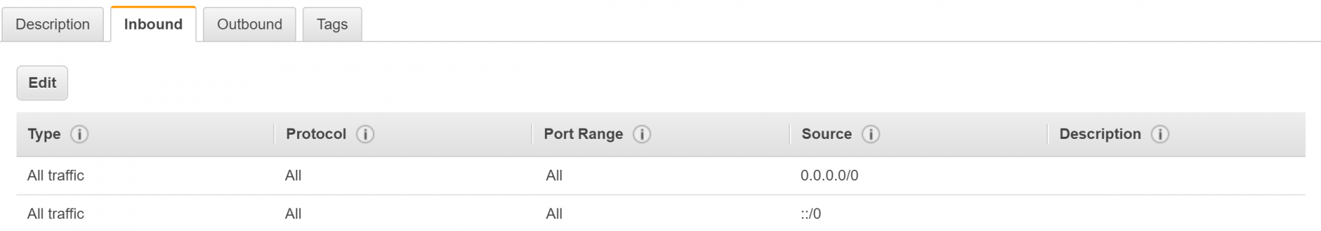

    thanks for getting back to me! i've opened all inbound ports like so:
    still can't get centminmod to install properly. do you have any suggestions?

    Just tried to run one-line install command on Google Cloud (where I usually host centminmod) and it has the same error. Could it be that there's an error with the script, or that one of the dependencies isn't loading properly?

    Well i haven't tested Centmin Mod on either Google Cloud or Amazon EC2 myself though others have. It is usually to do with the cloud provider's firewall.
