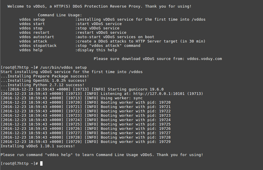

    i'm searching for a way to fight botnet and malicious ips
    beside csf, cloudflare , find this but i have not tested yet
    vDDoS, a HTTP(S) DDoS Protection
    website vDDoS Proxy Protection
    feature for security
    variable: no, 307, 200, click, 5s, high, captcha
    Sets a valid for Security Level Protection. Note: no < 307 < 200 < click < 5s < high < captcha
    system requirement
    • Informative Informative x 2
  15. narji
