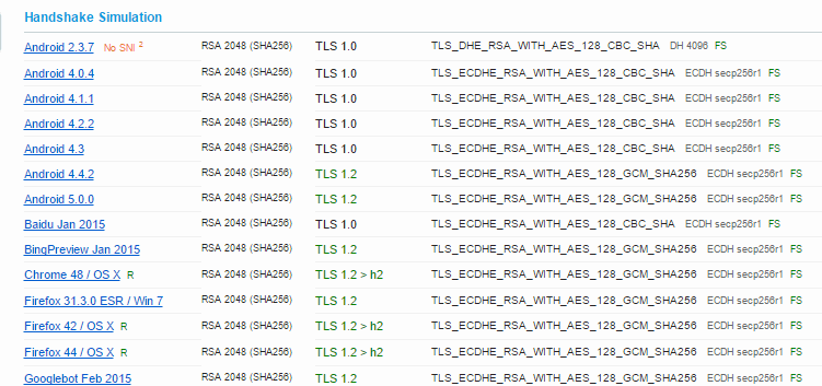

    Basically due to OpenSSL 1.0.2 much longer compile time, i setup Centmin Mod to only recompile OpenSSL itself when the version number in centmin.sh differed from one currently compiled in Nginx server itself. But if you're switching to a patched OpenSSL 1.0.2f you never get to use the patch as the version number in centmin.sh and Nginx are the same. So switched off the skipping so OpenSSL 1.0.2f is compiled everytime so Nginx can pick up the Cloudflare chacha20 patches to OpenSSL :)

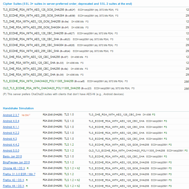

    looks good on the forums now SSL Server Test: community.centminmod.com (Powered by Qualys SSL Labs) using newer chacha20
    but not being picked up by Chrome for Android 5 ?
    Ah newer cloudflare patch has a new ssl cipher option need to add to nginx vhost!
    EECDH+CHACHA20:EECDH+CHACHA20-draft:
    so more updates to come
    might need to reverse the order of those new ssl ciphers
    strange even if i reverse the order Android 5 picks up older chacha20 ciphers
    ssl_ciphers     EECDH+CHACHA20-draft:EECDH+CHACHA20:EECDH+AES128:RSA+AES128:EECDH+AES256:RSA+AES256:EECDH+3DES:RSA+3DES:!MD5:!RC4:!3DES;
    Updated 123.09beta01 nginx ssl vhost templates Beta Branch - update nginx vhost template routine for chacha20 draft ciphers | Centmin Mod Community

    @eva2000 im using chacha in the top with this order:
      ssl_ciphers        "ECDHE-ECDSA-CHACHA20-POLY1305:ECDHE-RSA-CHACHA20-POLY1305:
    SSLabs also says that Android 5.0 uses AES128, but i enter the site with my smartphone using Android 5.1, and it uses chacha20. So this seems an issue with SSLabs. That, or there is a diference between 5.0 and 5.1.
    60,068
    12,574
    +19,228
    11:04 AM
    Ah must be Android 5.1+ only for newer chacha20 draft version ? Chrome on Android 5.1.x doesn't show draft or old tag just chacha20_poly1305. Checked on my Samsung Galaxy S2 with Cyanogen Mod 5.1.x and shows chacha20_poly1305 but no indication of it being draft or old version

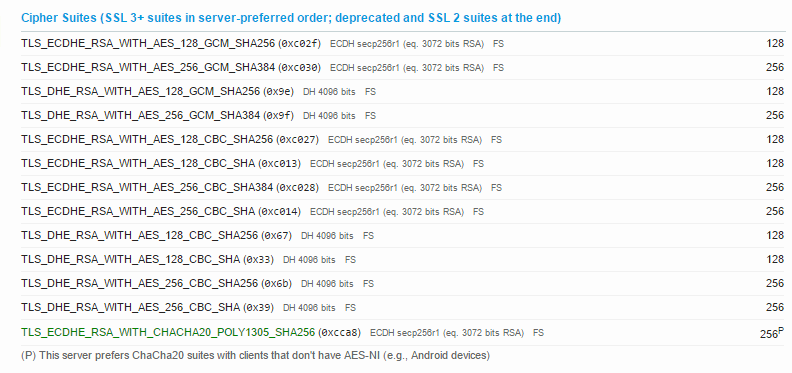

    Ok, SSLabs now says that Android 5.0 is using chacha20.
    The change i made: ssl_ciphers "EECDH+CHACHA20-draft:ECDHE-ECDSA-CHACHA20-POLY1305:ECDHE-RSA-CHACHA20-POLY1305:

    Updated my centminmod.com sites to latest 123.09beta01 fixed patches too and ssllab shows Android using old chacha20

    IE8-10 / Win7                 TLSv1.0 ECDHE-RSA-AES128-SHA
    IE11 / Win7                   TLSv1.2 ECDHE-RSA-AES128-SHA256
    IE11 / Win8.1                 TLSv1.2 ECDHE-RSA-AES128-SHA256
    IE10 / Win Phone 8.0          TLSv1.0 ECDHE-RSA-AES128-SHA
    IE11 / Win Phone 8.1          TLSv1.2 ECDHE-RSA-AES128-SHA256
    IE11 / Win Phone 8.1 Update   TLSv1.2 ECDHE-RSA-AES128-SHA256
    IE11 / Win10                  TLSv1.2 ECDHE-RSA-AES128-GCM-SHA256
    Edge 13 / Win10               TLSv1.2 ECDHE-RSA-AES128-GCM-SHA256
    Edge 12 / Win Phone 10        TLSv1.2 ECDHE-RSA-AES128-GCM-SHA256
    Java 6u45                     TLSv1 AES128-SHA
    Java 7u25                     TLSv1 ECDHE-RSA-AES128-SHA
    Java 8u31                     TLSv1.2 ECDHE-RSA-AES128-GCM-SHA256
    OpenSSL 0.9.8y                TLSv1 AES128-SHA
    OpenSSL 1.0.1l                TLSv1.2 ECDHE-RSA-AES128-GCM-SHA256
    OpenSSL 1.0.2                 TLSv1.2 ECDHE-RSA-AES128-GCM-SHA256
    Safari 5.1.9/ OSX 10.6.8      TLSv1 ECDHE-RSA-AES128-SHA
    Safari 6 / iOS 6.0.1          TLSv1.2 ECDHE-RSA-AES128-SHA256
    Safari 6.0.4/ OS X 10.8.4     TLSv1 ECDHE-RSA-AES128-SHA
    Safari 7 / iOS 7.1            TLSv1.2 ECDHE-RSA-AES128-SHA256
    Safari 7 / OS X 10.9          TLSv1.2 ECDHE-RSA-AES128-SHA256
    Safari 8 / iOS 8.4            TLSv1.2 ECDHE-RSA-AES128-SHA256
    Safari 8 / OS X 10.10         TLSv1.2 ECDHE-RSA-AES128-SHA256
    Safari 9 / iOS 9              TLSv1.2 ECDHE-RSA-AES128-GCM-SHA256
    Safari 9 / OS X 10.11         TLSv1.2 ECDHE-RSA-AES128-GCM-SHA256
