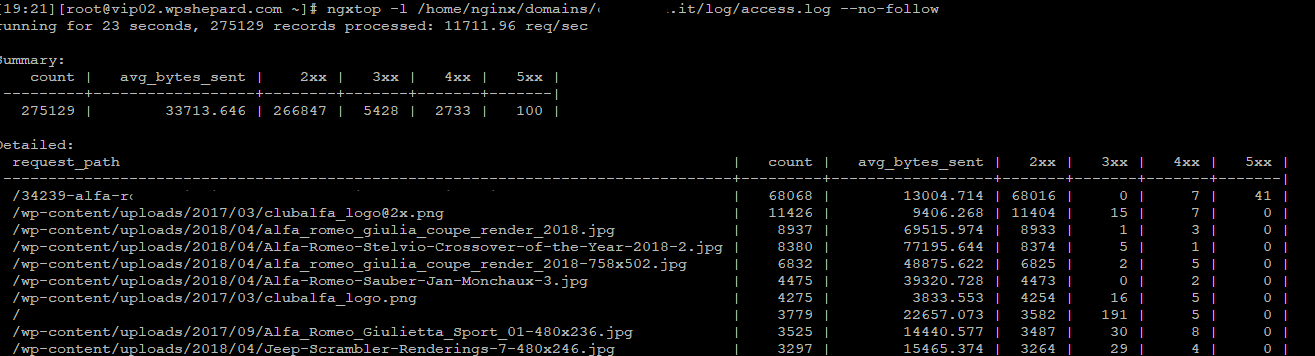

  4. upgrade81
    268
    16
    Sep 5, 2016
    CH
    +27
    6:52 PM
    1.17
    10.3
    ok this is today's historian
    this in real time
    Keep going 100% I have to restart nginx every 10 minutes.

    Unless you have a really weak cpu, 10 req/s can't cause that. Something must be messing with nginx.
    I have seen something similar some months ago, and it was a specific page. When someone entered that page, nginx would simple start using all resources. In this case it was a Topic, and we just deleted that topic. We never found the reason why it was happening.

  10. Revenge
    Revenge Active Member
    462
    93
    Feb 21, 2016
    Portugal
    +352
    5:52 PM
    1.9.x
    10.1.x
    Trial and error after many hours.
    In the image you posted of amplify, you have about 20 req/s and then you have 400 current requests. If you only receive 20 request each seconds, how the requests at the same time goes to 400? The only reason i see is that each request is taking a long time to complete.

    Here is the result of the analysis after eliminating the flush and buffer
    this the vm with Wordpress + Redis Cache
    Today the situation seems to have improved.
    But next time?
    Could it have been the usual flood attack?
     zcat -f /home/nginx/domains/xxxxx.it/log/access.log* | ngxtop --no-follow --order-by 'avg(bytes_sent) * count'
    running for 213 seconds, 3348394 records processed: 15702.49 req/sec
    Summary:
    |   count |   avg_bytes_sent |     2xx |    3xx |    4xx |   5xx |
    | 3348394 |        37726.623 | 3089816 | 100538 | 157453 |   385 |
    Detailed:
    | request_path                                                                    |   count |   avg_bytes_sent |   2xx |   3xx |   4xx |   5xx |
    | /wp-content/uploads/2018/03/180330_Alfa_Romeo_2017_Stelvio_Quadrifoglio.jpg     |   24796 |       332399.470 | 24759 |    16 |    21 |     0 |
    | /wp-load.php                                                                    |    2047 |      3192693.137 |  2047 |     0 |     0 |     0 |
    | /wp-content/uploads/2018/03/fca.jpg                                             |   16833 |       226641.179 | 16821 |     9 |     3 |     0 |
    | /wp-content/uploads/2018/03/dipendenti-maserati-grugliasco_2018.jpg             |   19048 |       168596.250 | 19022 |    11 |    15 |     0 |
    | /wp-content/uploads/2018/03/Fiat-Chrysler-Automobiles-addio-Serbia-1.jpg        |   26968 |        80215.234 | 26889 |    66 |    13 |     0 |
    | /wp-content/cache/css/aggregati_bb72063050502829c1e5d64a1ac993be.css            |   35592 |        55592.893 | 35529 |    52 |    11 |     0 |
    | /wp-content/uploads/2018/04/Alfa-Romeo-Giulia-Quadrifoglio-USA-43-1.jpg         |   13542 |       128797.347 | 13517 |     6 |    19 |     0 |
    | /wp-content/uploads/2018/03/Alfa-Romeo-Stelvio-Nero-Edizione-5.jpg              |   28764 |        60075.638 | 28650 |    93 |    21 |     0 |
    | /wp-content/uploads/2017/12/Alfa-Romeo-Stelvio-Quadrifoglio-1.jpg               |    9912 |       168755.997 |  9890 |    22 |     0 |     0 |
    | /wp-content/uploads/2018/03/Fiat-Chrysler-Automobiles-Goiana-pieno-regime-1.jpg |   13306 |       119250.662 | 13292 |     9 |     5 |     0 |
    zcat -f /home/nginx/domains/xxxx.it/log/access.log* | ngxtop --no-follow avg bytes_sent --filter 'status == 200 and request_path.startswith("/wp-content")'
    running for 267 seconds, 2376556 records processed: 8909.15 req/sec
    average ['bytes_sent']
    |   avg(bytes_sent) |
    |         45067.186 |

    zcat -f /home/nginx/domains/forum.xxxxxxx.it/log/access.log* | grep '07/Apr/2018' | ngxtop --no-follow top http_user_agent -i 'status >= 200' -n10
    running for 22 seconds, 289492 records processed: 12948.53 req/sec
    top http_user_agent
    | http_user_agent                                                                                                                          |   count |
    | Mozilla/5.0 (compatible; bingbot/2.0; +http://www.bing.com/bingbot.htm)                                                                  |   26532 |
    | Googlebot-Image/1.0                                                                                                                      |   18684 |
    | Mozilla/5.0 (Windows NT 10.0; WOW64; rv:55.0) Gecko/20100101 Firefox/55.0                                                                |   13440 |
    | Mozilla/5.0 (Windows NT 10.0; Win64; x64) AppleWebKit/537.36 (KHTML, like Gecko) Chrome/65.0.3325.181 Safari/537.36                      |   13034 |
    | Mozilla/5.0 (iPhone; CPU iPhone OS 11_2_6 like Mac OS X) AppleWebKit/604.5.6 (KHTML, like Gecko) Version/11.0 Mobile/15D100 Safari/604.1 |   11412 |
    | Mozilla/5.0 (Windows NT 5.1) AppleWebKit/537.36 (KHTML, like Gecko) Chrome/46.0.2490.86 Safari/537.36 BYO-4/7.1.13                       |   10162 |
    | Mozilla/5.0 (compatible; Googlebot/2.1; +http://www.google.com/bot.html)                                                                 |    8097 |
    | Mozilla/5.0 (compatible; proximic; +https://www.comscore.com/Web-Crawler)                                                                |    6990 |
    | Mozilla/5.0 (Windows NT 10.0; Win64; x64; rv:59.0) Gecko/20100101 Firefox/59.0                                                           |    6538 |
    | Mozilla/5.0 (compatible; GrapeshotCrawler/2.0; +http://www.grapeshot.co.uk/crawler.php)                                                  |    6014 |
    zcat -f /home/nginx/domains/forum.xxxxx.it/log/access.log* | grep '07/Apr/2018' | ngxtop --no-follow top http_user_agent -i 'status >= 444' -n10
    running for 20 seconds, 1989 records processed: 101.68 req/sec
    top http_user_agent
    | Mozilla/5.0 (Windows NT 10.0; Win64; x64; rv:59.0) Gecko/20100101 Firefox/59.0                                                                   |    1036 |
    | Mozilla/5.0 (Windows NT 6.1; Win64; x64; rv:59.0) Gecko/20100101 Firefox/59.0                                                                    |     257 |
    | Mozilla/5.0 (Windows NT 6.3; Win64; x64; rv:59.0) Gecko/20100101 Firefox/59.0                                                                    |     170 |
    | Mozilla/5.0 (Macintosh; Intel Mac OS X 10.13; rv:59.0) Gecko/20100101 Firefox/59.0                                                               |      94 |
    | Mozilla/5.0 (Windows NT 6.1; rv:59.0) Gecko/20100101 Firefox/59.0                                                                                |      89 |
    | Mozilla/5.0 (X11; Ubuntu; Linux x86_64; rv:59.0) Gecko/20100101 Firefox/59.0                                                                     |      76 |
    | Mozilla/5.0 (Windows NT 10.0; WOW64; rv:56.0) Gecko/20100101 Firefox/56.0                                                                        |      32 |
    | Mozilla/5.0 (Linux; Android 8.0.0; Mi A1 Build/OPR1.170623.026) AppleWebKit/537.36 (KHTML, like Gecko) Chrome/65.0.3325.109 Mobile Safari/537.36 |      24 |
    | Mozilla/5.0 (Macintosh; Intel Mac OS X 10.9; rv:59.0) Gecko/20100101 Firefox/59.0                                                                |      17 |
    | Mozilla/5.0 (Windows NT 6.1; WOW64; rv:59.0) Gecko/20100101 Firefox/59.0                                                                         |      16 |

    what's output for
    nginx -V
    from /var/log/messages, ngx_brotli is segfaulting it seems in nginx
    Apr  7 19:48:10 vip03 kernel: nginx[23327]: segfault at 30 ip 00007fc52f461959 sp 00007ffceb034090 error 4 in ngx_http_brotli_filter_module.so[7fc52f460000+3000]
    Try updating to latest 123.09beta01, run cmpupdate command and then recompiling centmin.sh menu option 4 to get the latest nginx version with latest ngx_brotli module and see. If still segfaulting (check timestamps in /var/log/messages against entries), then try recompile centmin.sh menu option 4 without ngx_brotli in /etc/centminmod/custom_config.inc

    46,662
    10,591
    +16,437
    2:52 AM
    127.0.0.1 is normal for request/visitor IP depending what is running
    try with ngx_brotli disabled and see but all monitoring tools outline at bottom of my post here are also useful to figure out where load is coming from
    46,662
    10,591
    +16,437
    2:52 AM
    looks like bingbot and google image crawler bot related so rate limiting them by user agent might help
