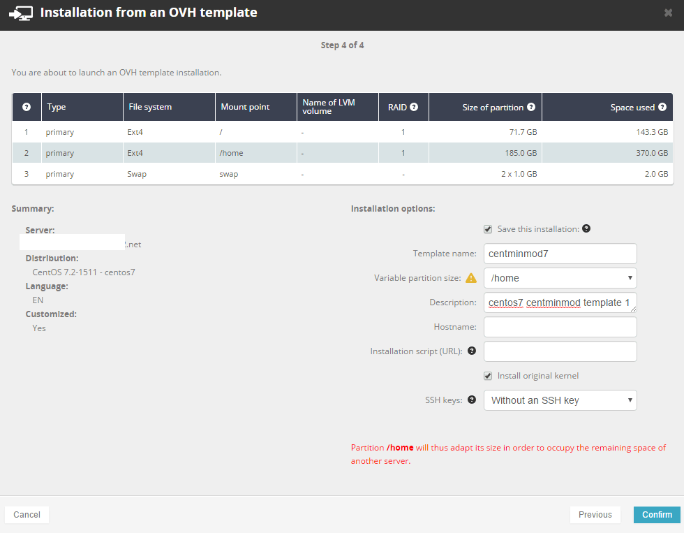

    means nginx failed to install and it could be because you're using ovh's custom kernel and not centos distro kernel
    from install page Centmin Mod LEMP Stack Install Nginx on CentOS
    example for my OVH server with centos 7 distro kernel selected OVH - OVH Intel Core i7 4790K 32GB 2x240GB Samsung PM863 SSD Review | Centmin Mod Community

    for OVH after selecting OS you can customise partition and install from template and there you can check a box that says install original kernel
