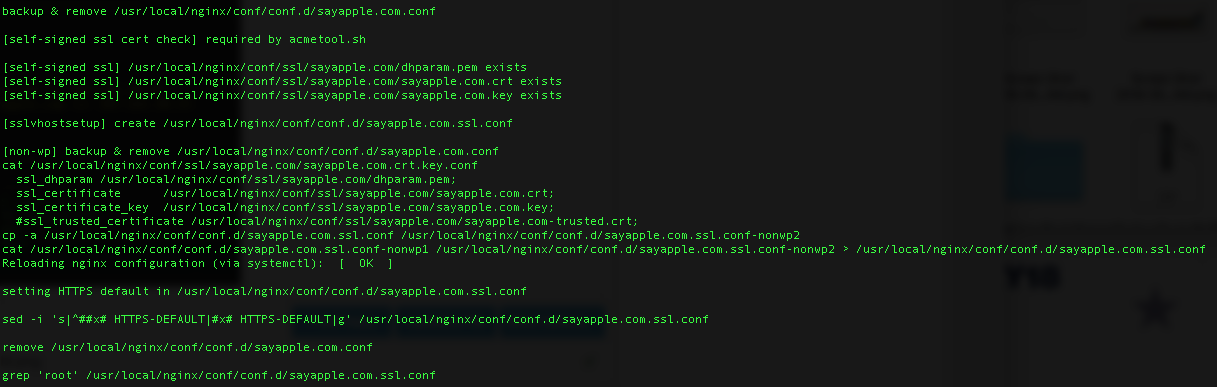

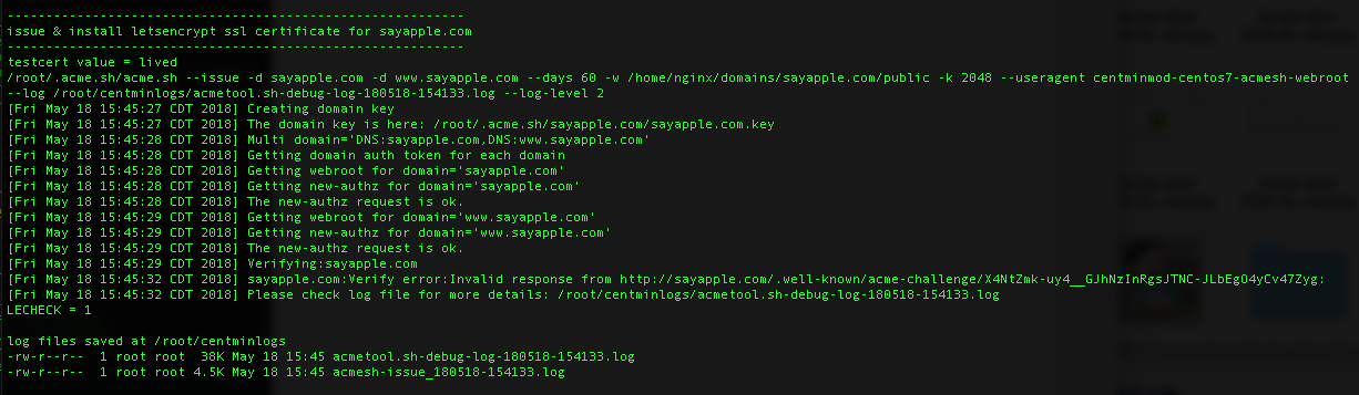

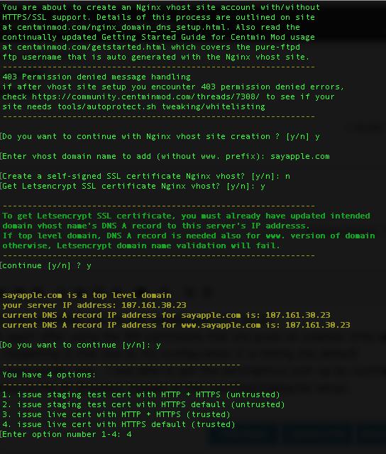

    Used option 2 to create the vhost... and then selected <N> to self signed and <Y> to LE.
    Just tried it (new install for the domain) again after using the RM commands that are given at creation time and still getting the same issue. I think what is happening is that due to my configuration it is hitting the default redneckhost.com website instead of the appropriate one. I was able to get the servinglinux.com up by running it manually - but it puts the certs in the /root/acme.sh directory instead of the /usr/local/nginx/ssl setup.
    The vhost is the default one that is created... but when I change it to this (for the server stanzas)
    # ipv4
        listen [2604:180:0:5::45]:80;
        listen   107.161.30.23:80;
        server_name sayapple.com www.sayapple.com;
        return 302 https://sayapple.com$request_uri;
        return 301 https://$server_name$request_uri;
        listen  107.161.30.23:443 ssl http2;
        listen [2604:180:0:5::45]:80 ;
        listen [2604:180:0:5::45]:443 ssl http2;
    and then restart nginx and run
     /root/.acme.sh/acme.sh --issue -d sayapple.com -d www.sayapple.com --days 60 -w /home/nginx/domains/sayapple.com/public -k 2048 --useragent centminmod-centos7-acmesh-webroot --log /root/centminlogs/acmetool.sh-debug-log-180518-154133.log --log-level 2
    the certificate is generated fine as the domain is now responding instead of the default domain (redneckhost.com).
    The only issue is that it generates the SSL related files at an alternative location (/root/.acme.sh/sayapple.com/sayapple.com.???) and I have to modify the .conf file or make symbolic links.
    And yes, I know it's sayapple.com and not servinglinux.com - was working on both domains and the servinglinux.com was already up and running and the sayapple.com wasn't so worked with that one for the latest example. ;)
