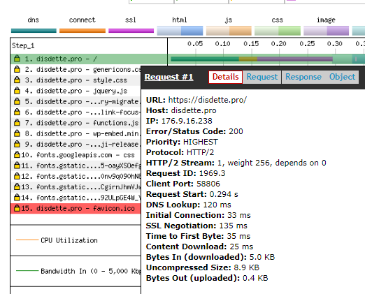

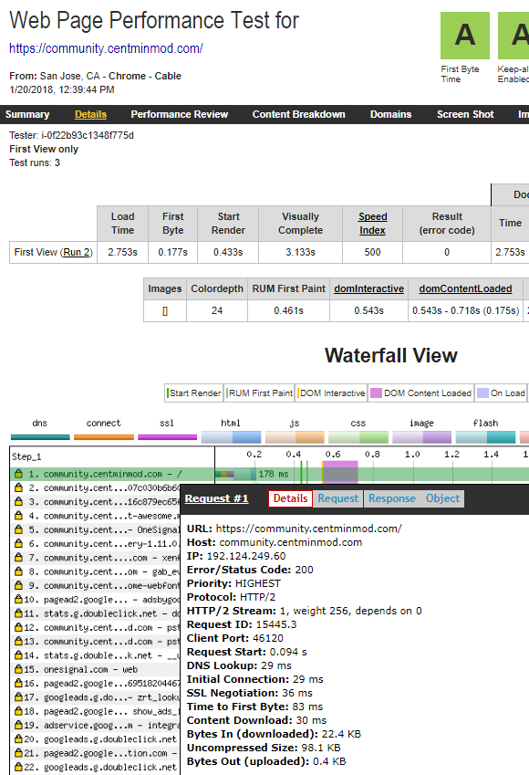

    strange so chrome looks fine in webpagetest.org WebPagetest Test Result - Dulles : samsungmobile.it - 01/19/18 23:48:07
    microsoft edge in webpagetest.org doesn't WebPagetest Test Result - Dulles : edge : samsungmobile.it - 01/19/18 23:49:33
    waterfall shows request cancelled WebPagetest Test Details - Dulles : edge : samsungmobile.it - 01/19/18 23:49:33

    another strange thing is the TTFB made by frankfurt, the server is relatively close 50km "hetzner".
    WebPagetest Test Result - Frankfurt : disdette.pro - 01/20/18 01:33:10
    On a virtually empty site it results on the .300ms.
    Mysteries
    43,082
    9,781
    +15,101
    10:11 PM
    TTFB slower as you tested non-HTTPS version of domain with added extra overhead of a 301 redirect to HTTPS added to the time. Test HTTPS version of your domain though that doesn't make much difference so could be the actual web host's server that is slow WebPagetest Test Details - Frankfurt : disdette.pro - 01/20/18 02:34:46
    Also Webpagetest TTFB includes DNS time and that for your domain ~120ms
    example for my forums reported TTFB (= DNS lookup + Initial Connection + SSL negotation + SSL negotiation) by WPT and first byte breakdown

    Sorry for my mistake of not having directly tested the https version.
    it's also true that the https version is poor given the proximity of the server to frankfurt.
    I do not know what to say is a dedicated with nvme disks and practically a load at 0.
