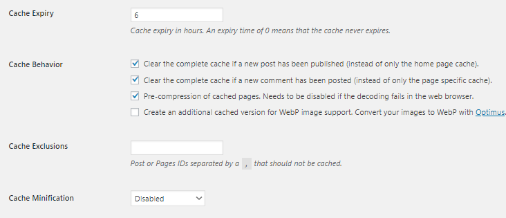

    Also cache enabler can exclude caches by post or page ids too, so if the form is embedded into a custom page, you can add page id to excluded caching

    Thanks, yeah I'll try the exclude cache by post ID too ;-)

    no clue not a PHP programmer heh. Excluding post id from cache enabler would rule out cache enabler (the plugin) as the issue if it still happens.

    OK so in case someone has the issue someday : despite nginx config saying that URL query parameters shouldn't be cached, somehow GravityForm dynamic field population based on URL query parameters IS GETTING CACHED... so basically the form gets populated with always the same parameter no matter was is passed in the URL.
    Now the good new: excluding by POST IDS inside the Cache Enabler plugin did solve the problem.
    I'm not exactly sure what's going on but at least I found a working configuration.

    Indeed probably best way.. don't think Nginx can known when dynamic query strings are appended/inserted
