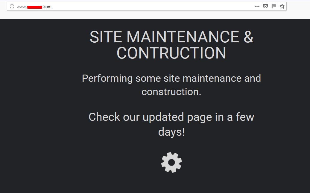

    Perect, even added a tracking code so that I can see what countries have the prioritie to start!

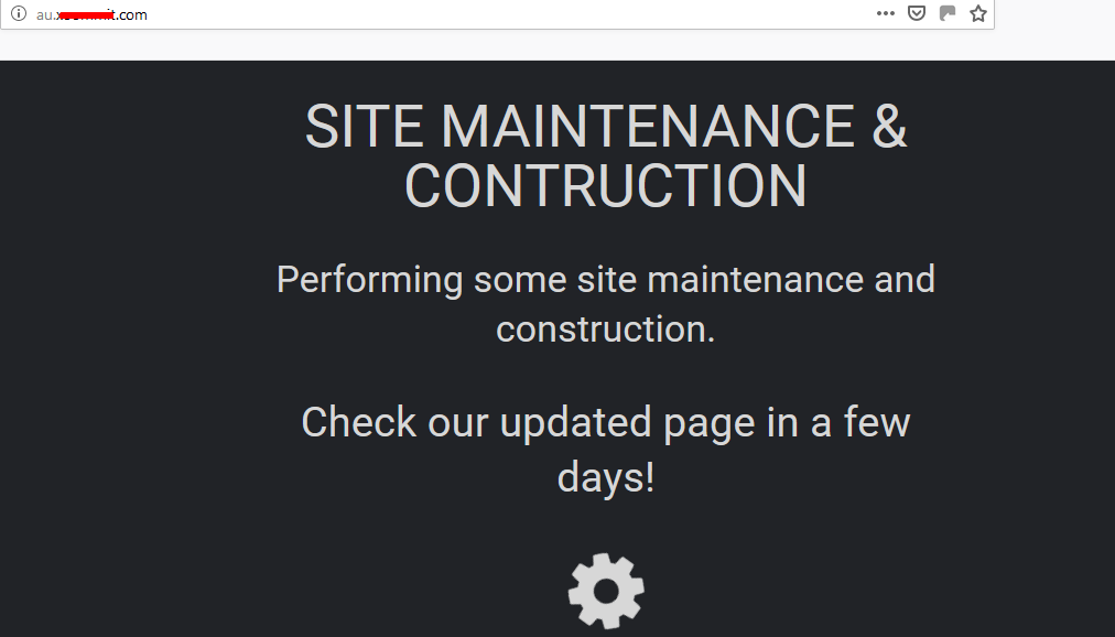

    Well, disabling Cloudflare resolved it. I only created the DNS but had also the Proxy on. So disabling the proxy resolved the issue.
    Now, for example, the domain ir.domain.com for Ireland gives the index.html (converted maintenance page with a tracker) again. And au.domain.com for Australia. Only I can't use https. But I placed all links from the countie sites on serval sites to get response, and that works.
    So I still have the possibility to check the priority for the countries where we should start our new sites.
    With this way, I don't have to create domains with option 2 or 22 and still get my valuable info. Just created for 100+ countries a DNS a record with the IP pointing to the server.

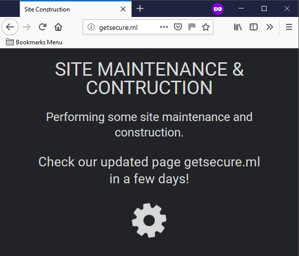

    Updated the page, now even showing domain name:):)

    Now figuring out how to autotranslate it based on browser language!
    Obs. Posting image on test domain, so IP of server keeps secret!
