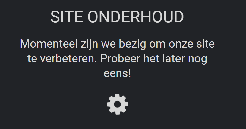

    Ha, just updated /usr/local/nginx/conf/maintenance.conf with all domains and set several to 1; Added several IP's for developers that update some sites. Real life saver!
    Some of these sites are/were a mess, so rather put them into maintenance mode. The maintenance page says "Site" not "Server". Translated them to have the correct language and changed the color to a dark theme, as this is more modern. Most applications today have an option for a dark mode.
