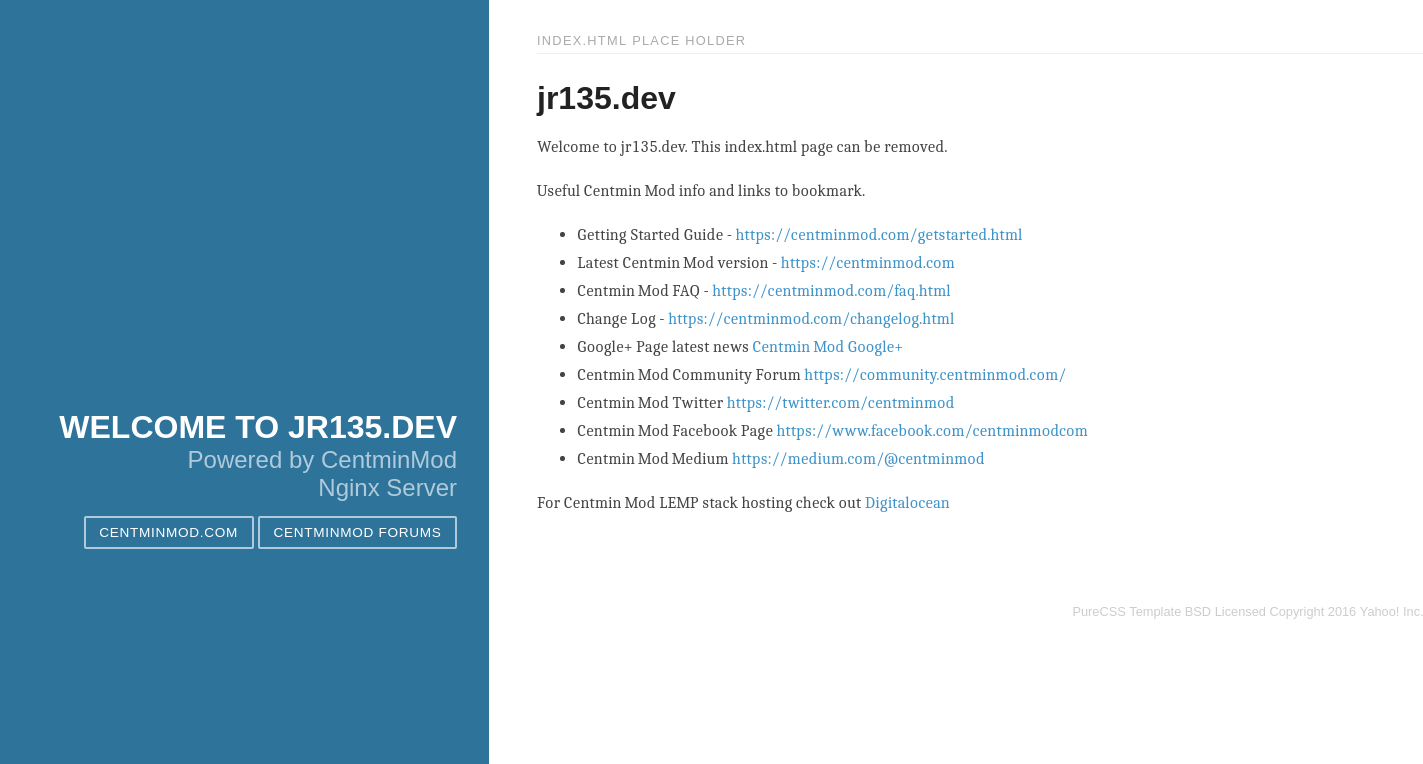

    If I enter https://10.0.0.135, works great. Too bad using the IP won't work in the script.

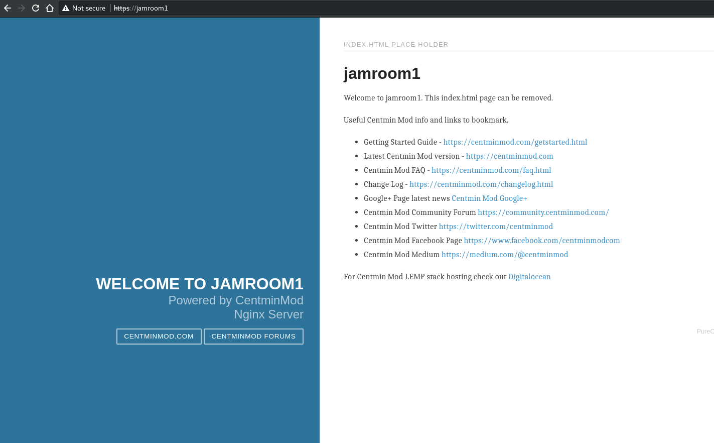

    Testing:
    A. jamroom1. Entered https://jamroom1 and everything worked great.
    # For HTTP/2 SSL Setup
    # read http://centminmod.com/nginx_configure_https_ssl_spdy.html
    # redirect from www to non-www  forced SSL
    # server {
    #       listen   80;
    #       server_name jamroom1 www.jamroom1;
    #       return 302 https://$server_name$request_uri;
      listen 10.0.0.135:443 ssl http2;
      ssl_dhparam /usr/local/nginx/conf/ssl/jamroom1/dhparam.pem;
      ssl_certificate      /usr/local/nginx/conf/ssl/jamroom1/jamroom1.crt;
      ssl_certificate_key  /usr/local/nginx/conf/ssl/jamroom1/jamroom1.key;
      # cloudflare authenticated origin pull cert community.centminmod.com/threads/13847/
      #ssl_client_certificate /usr/local/nginx/conf/ssl/cloudflare/jamroom1/origin.crt;
      #ssl_verify_client on;
      http2_max_field_size 16k;
      http2_max_header_size 32k;
      # mozilla recommended
      ssl_ciphers ECDHE-ECDSA-CHACHA20-POLY1305:ECDHE-RSA-CHACHA20-POLY1305:ECDHE-ECDSA-AES128-GCM-SHA256:ECDHE-RSA-AES128-GCM-SHA256:ECDHE-ECDSA-AES256-GCM-SHA384:ECDHE-RSA-AES256-GCM-SHA384:DHE-RSA-AES128-GCM-SHA256:DHE-RSA-AES256-GCM-SHA384:ECDHE-ECDSA-AES128-SHA256:ECDHE-RSA-AES128-SHA256:ECDHE-ECDSA-AES128-SHA:ECDHE-RSA-AES256-SHA384:ECDHE-RSA-AES128-SHA:ECDHE-ECDSA-AES256-SHA384:ECDHE-ECDSA-AES256-SHA:ECDHE-RSA-AES256-SHA:DHE-RSA-AES128-SHA256:DHE-RSA-AES128-SHA:DHE-RSA-AES256-SHA256:DHE-RSA-AES256-SHA:ECDHE-ECDSA-DES-CBC3-SHA:ECDHE-RSA-DES-CBC3-SHA:EDH-RSA-DES-CBC3-SHA:AES128-GCM-SHA256:AES256-GCM-SHA384:AES128-SHA256:AES256-SHA256:AES128-SHA:AES256-SHA:DES-CBC3-SHA:!DSS;
      #add_header X-Xss-Protection "1; mode=block" always;
      #add_header X-Content-Type-Options "nosniff" always;
      #spdy_headers_comp 5;
      ssl_buffer_size 1369;
      ssl_session_tickets on;
      # enable ocsp stapling
      #resolver 8.8.8.8 8.8.4.4 valid=10m;
      #resolver_timeout 10s;
      #ssl_stapling on;
      #ssl_stapling_verify on;
      #ssl_trusted_certificate /usr/local/nginx/conf/ssl/jamroom1/jamroom1-trusted.crt;
      # limit_conn limit_per_ip 16;
      # ssi  on;
      access_log /home/nginx/domains/jamroom1/log/access.log combined buffer=256k flush=5m;
      error_log /home/nginx/domains/jamroom1/log/error.log;
      include /usr/local/nginx/conf/autoprotect/jamroom1/autoprotect-jamroom1.conf;
      root /home/nginx/domains/jamroom1/public;
      # server and/or vhost site
    # block common exploits, sql injections etc
    #include /usr/local/nginx/conf/block.conf;
      #autoindex  on;
      # Shows file listing times as local time
      #autoindex_localtime on;
      # Wordpress Permalinks example
      include /usr/local/nginx/conf/pre-staticfiles-local-jamroom1.conf;

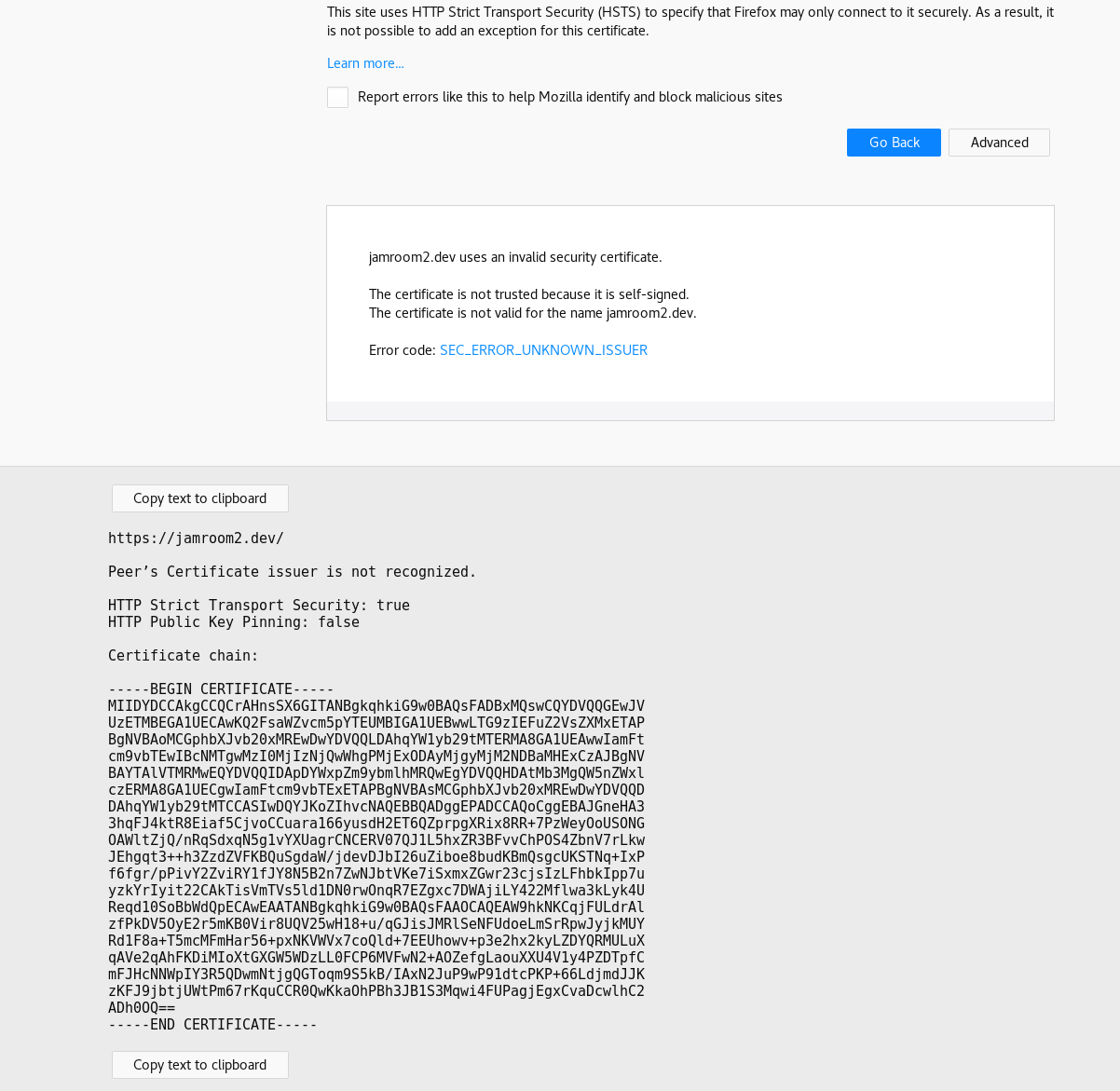

    B. jamroom2.dev. Entered https://jamroom2.dev and got the HSTS error.
    I noticed on this one that if I enter https://10.0.0.135 the site works fine and shows me the jamroom2.dev CMM default page.
    # server {
    #       listen   80;
    #       server_name jamroom2.dev www.jamroom2.dev;
      ssl_dhparam /usr/local/nginx/conf/ssl/jamroom2.dev/dhparam.pem;
      ssl_certificate      /usr/local/nginx/conf/ssl/jamroom2.dev/jamroom2.dev.crt;
      ssl_certificate_key  /usr/local/nginx/conf/ssl/jamroom2.dev/jamroom2.dev.key;
      #ssl_client_certificate /usr/local/nginx/conf/ssl/cloudflare/jamroom2.dev/origin.crt;
      #ssl_stapling on;
      #ssl_trusted_certificate /usr/local/nginx/conf/ssl/jamroom2.dev/jamroom2.dev-trusted.crt;
      # ssi  on;
      access_log /home/nginx/domains/jamroom2.dev/log/access.log combined buffer=256k flush=5m;
      error_log /home/nginx/domains/jamroom2.dev/log/error.log;
      include /usr/local/nginx/conf/autoprotect/jamroom2.dev/autoprotect-jamroom2.dev.conf;
      root /home/nginx/domains/jamroom2.dev/public;
      #autoindex  on;
      include /usr/local/nginx/conf/pre-staticfiles-local-jamroom2.dev.conf;
    Tried the above on multiple browsers, yielded the same results.
    Note: 10.0.0.135 vhost file was removed from the server. There was an IP site setup on .135 but I removed the entire account before testing.
    Why would CMM be fine for jamroom1 but not for jamroom2.dev?
