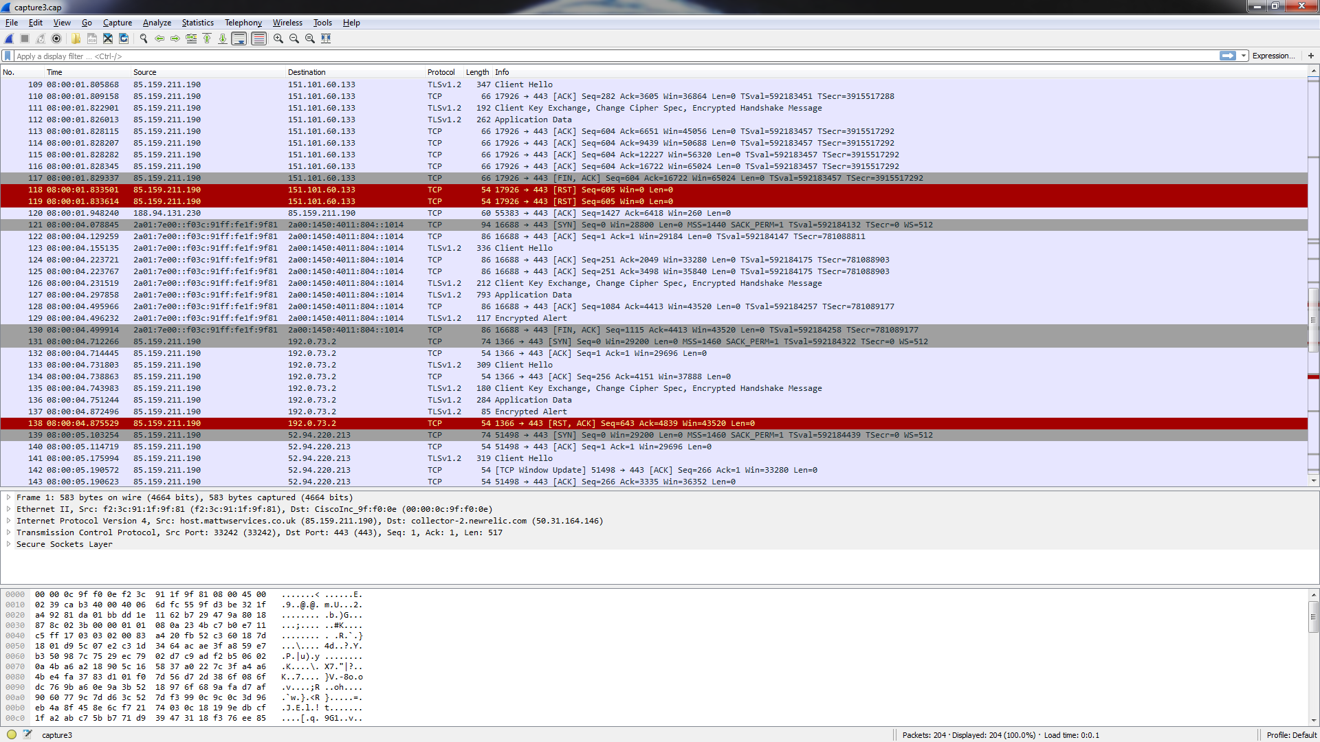

    Myself and @Amin Sabet have started getting this same error now, when the server tries to connect to Google via IPV6

    Interesting but it isn't the same cause as before right ? As i fixed that but i see the Unknown CA in there

    Correct, last time it was failing on IPv4 also, because of the below entry.
    openssl.cafile = '/etc/ssl/certs/cacert.pem'
    I'm going to switch PHP out to OpenSSL and see if it's an issue with LibreSSL

    This is an issue with LibreSSL.
    Removed the PHP_CUSTOMSSL switch from custom_config.inc
    PHP_CUSTOMSSL='y'
    Works fine now.
