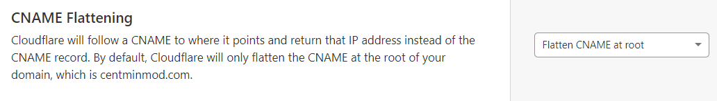

    Try enabling CNAME Flattening in Cloudflare DNS tab
    i.e.

    It is already at that option but gray and i can't change it....
    I don't think that it will work without an A record :(

    Need to have paid CF pro, business or enterprise plan for non root flattening Understand and configure CNAME Flattening
    so should work for you if CNAME IP is same as your domain root main IP.
