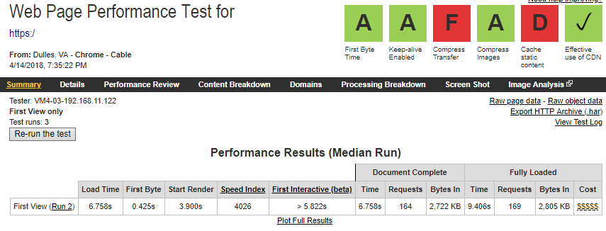

    Definitely invest in the time to learn how to use webpagetest.org from above linked how to guide as it's the best tool and should be your go to for page load speed optimisation ;)

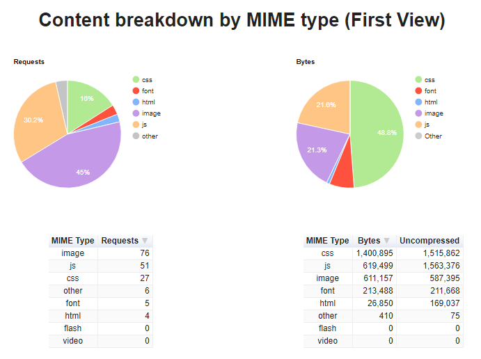

    I'll give you a few hints for your page
    1. too large page load size at 2800KB = 2.8MB nearly ! Should keep page size below 500-1000KB if possible.
    2. too many http requests/assets on page at 169 requests
    3. too many images and large js,css requests some css files are individually larger than 400KB !

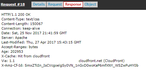

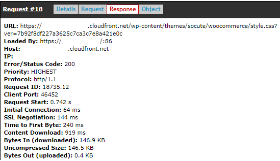

    4. you Amazon AWS Cloudfront CDN is misconfigured for HTTPS HTTP/1.1 instead of HTTPS HTTP/2 and also gzip compression is disabled for css & js files instead of enabled. So you're serially loading via HTTPS HTTP/1.1 very large uncompressed css and js files with many of them instead of concurrently loading via HTTPS HTTP/2 compressed gzip assets. Amazon AWS Cloudfront CDN has supported HTTPS HTTP/2 protocol since 2016 Amazon CloudFront now supports HTTP/2
    Example for webpagetest.ogr in Dulles, VA US East Coast for Chrome browser with Cable 5Mbps speeds - actual decent times for 2.8MB page size but on slower ISP connections and mobile 3G would still be very very slow to load for 2.8MB
    76 images, 51 js and 27 css on index alone !
    Amazon AWS Cloudfront misconfigurations for css files set to HTTPS HTTP/1.1 with gzip compression disabled
