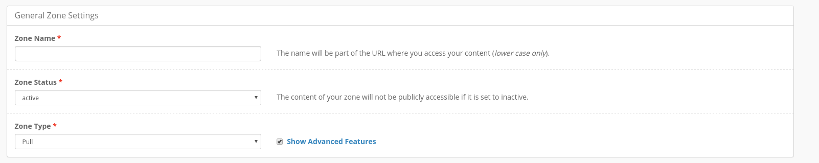

    ZONE SETUP
    2. Zone name - I'm assuming this is the sub-domain - ie zonename.keycdn.com? So here I would enter zonename?

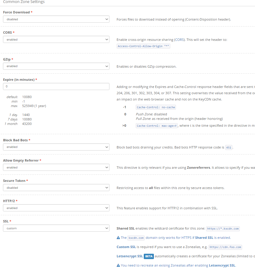

    COMMON ZONE SETTINGS
    3. Force Download? Advantages / disadvantages to enabling / disabling this?
    4. CORS? Advantages / disadvantages to enabling / disabling this?
    5. Any recommendations on Expire?
    6. Allow Empty Referrer? Recommendations for this?
    7. SSL - asks for a SSL cert. I should purchase a cert for whatever the Zonealias is? ie whatever.domain.com?
    8. If I'm using a SSL, should I force SSL if my site is all SSL?

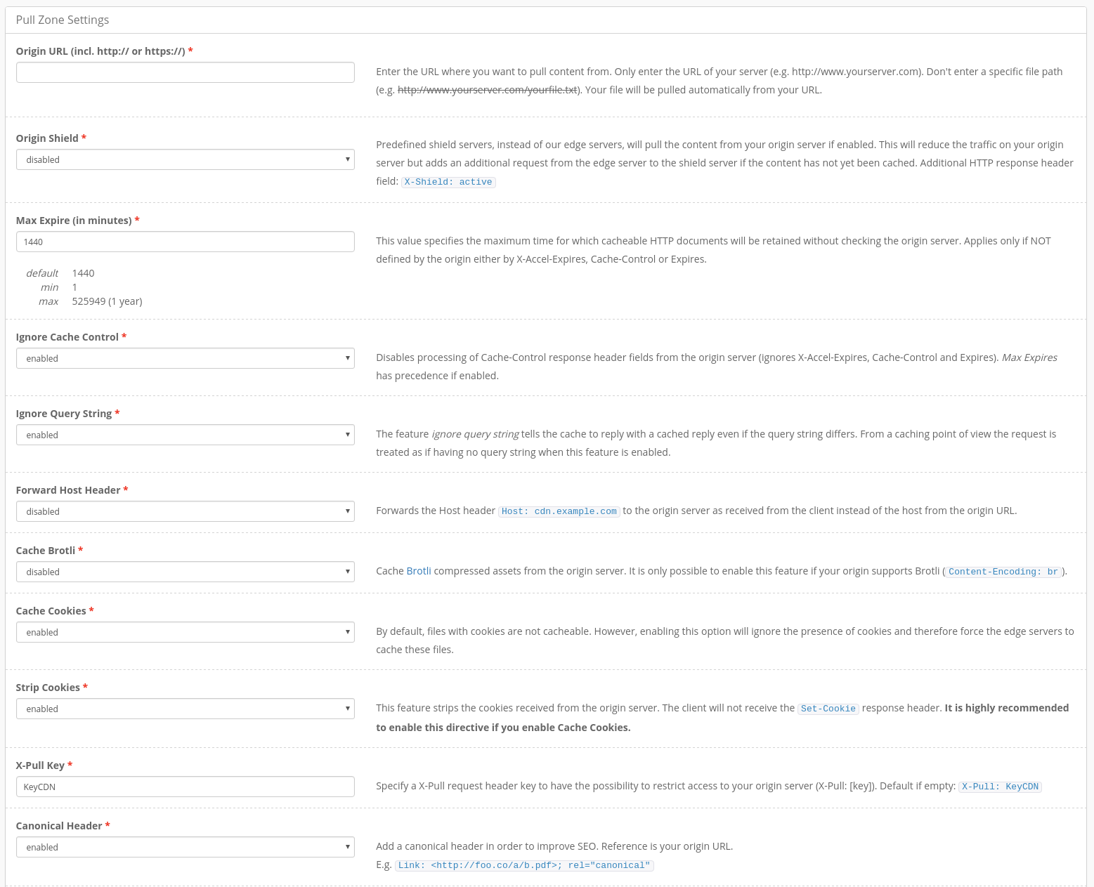

    PULL ZONE SETTINGS #1
    9. Should I use the Origin Shield?
    10. Max Expire? Recommend settings?
    11. Ignore Cache Control? Recommend settings?
    12. Ignore Query String? Recommend settings?
    13. Forward Host Header? Should I enable this?
    14. Cache Cookies / Strip Cookies? What settings are the best here?
    15. X-Pull Key - if using an SSL should this be changed?

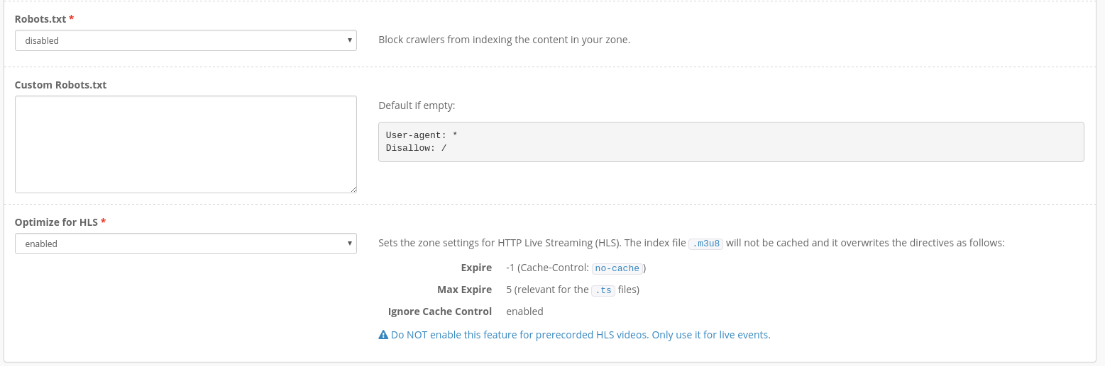

    PULL ZONE SETTINGS #2
    16. Custom Robots.txt. Centmin Mod has bad bots, should I populate this with that list?
