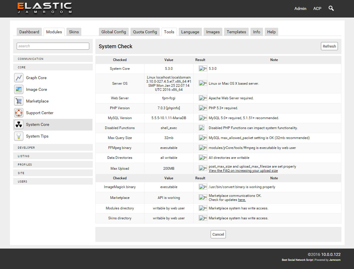

    @eva2000 what's the different between running the ownership root:nginx vs. nginx:nginx.
    The reason I'm asking is that with Jamroom I'm was not able to execute du, convert, or diff and they're all installed (on the server) and the locations are correct (in the script). The script has a basic function to test if those are executable and the results were returning false. I did the chmod to nginx:nginx and now everything is working fine except for the ImagicK which is still showing as "not executable".
    I guess I'm just curious which is better root:nginx or nginx:nginx? Would there be any security issues with one over the other? Is it recommended to chmod the public directory for most installs? I'm running IPB 4 with root:nginx and it seems to work fine.

    So is the open_basedir the reason ImagicK isn't working?
    5:22 AM
    could be if php is calling convert or other ImagicK commands outside of public directory

    Still having issues with some of the images in the ACP. The developer said he got it working on a vanilla nginx install using
            listen 80 default_server;
            listen [::]:80 default_server ipv6only=on;
            client_max_body_size 256M;
            root /usr/share/nginx/html;
            server_name ubuntu.jamroom.net;

    But I can't get the images to display with my version of the conf file.
    Do you see anything in there that would need to be changed in one of the include files. I didn't.

  15. Jimmy
    3:22 PM
    That's it! Got the images showing.

    Those images are "special" images. The developer has those only in the ACP and they have a special path. I'm going to check with the developer to see if he has any thoughts.
    Below is the location that is causing the issue for the ACP images.
    location ~* \.(3gp|gif|jpg|jpeg|png|ico|wmv|avi|asf|asx|mpg|mpeg|mp4|pls|mp3|mid|wav|swf|flv|exe|zip|tar|rar|gz|tgz|bz2|uha|7z|doc|docx|xls|xlsx|pdf|iso)$ {
        gzip_static off;
        #add_header Pragma public;
        add_header Cache-Control "public, must-revalidate, proxy-revalidate";
        access_log off;
        expires 30d;
        break;
    5:22 AM
    depending on image url path you can do the same as what you did to exclude some .php locations via specifying a specific path location match for those special image paths so it isn't matched by staticfiles.conf defined image location match
