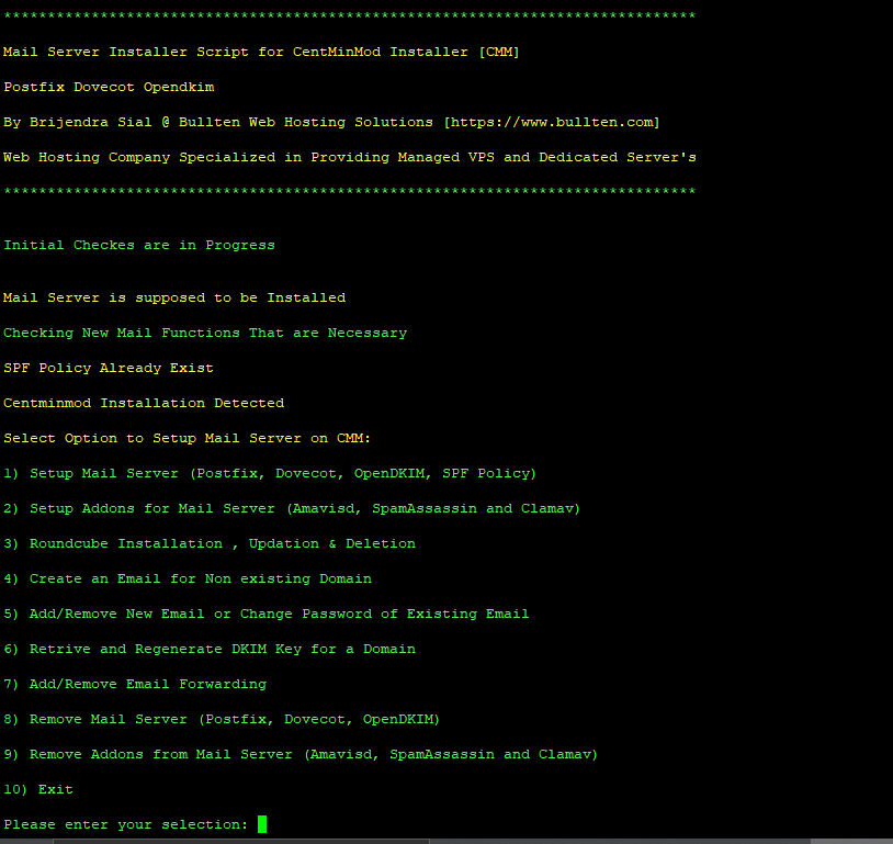

    I'm trying to install the mailserver, the script is asking me for "hostname" and "domain".
    for hostname I need to enter "host.domain.ext"
    Am I right? Or for hostname it means only the specific third level domain (in my example "host")?

    Hostname is hostname of your server. Like server.yourdomain.com
    uname -n will print the hostname of server and it should be valid FQDN.
