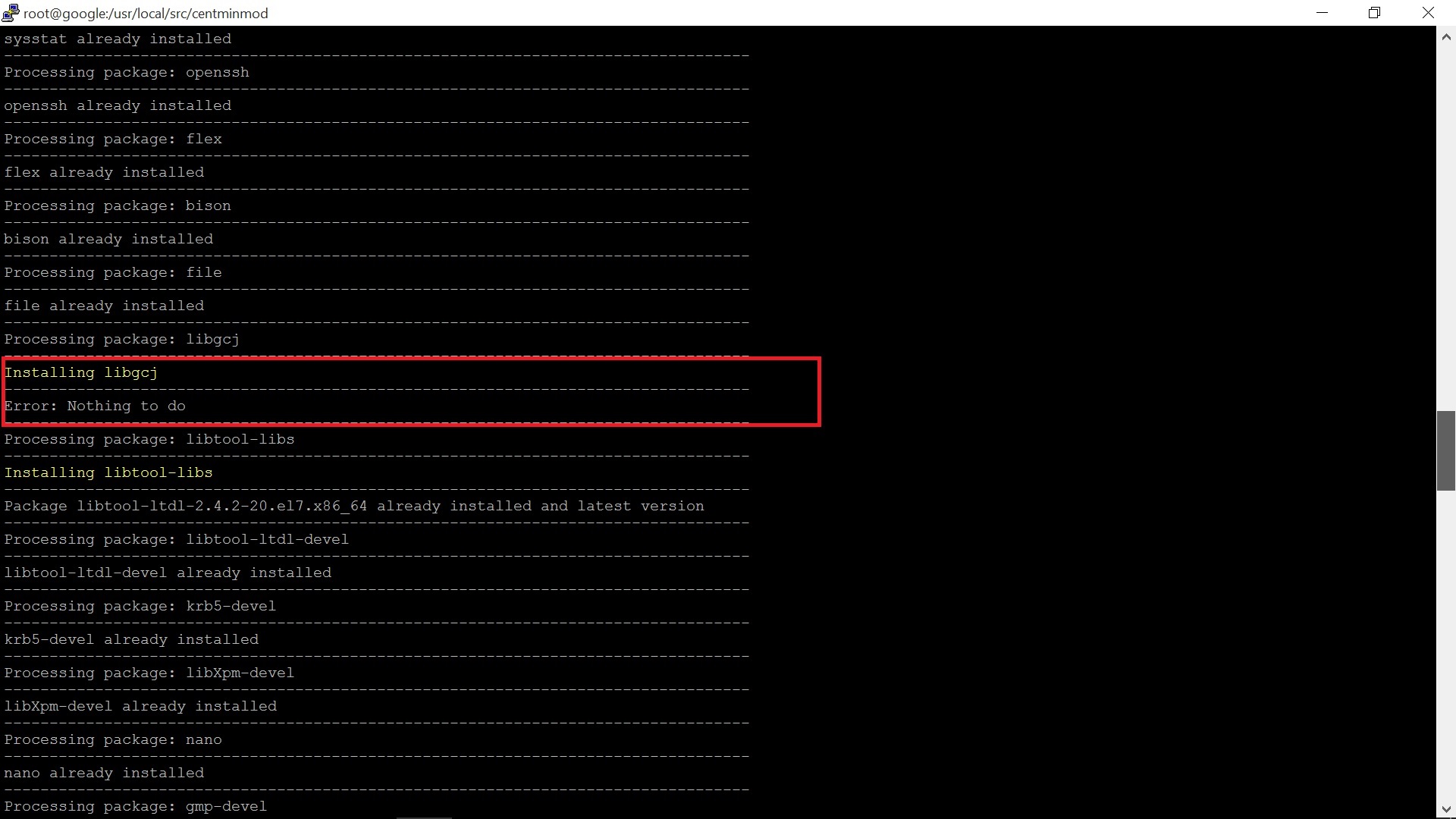

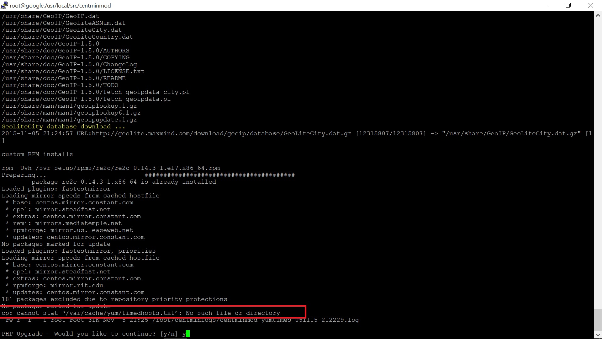

    Moving onto upgrading to php 7 and noticed 2 small issues.
    Going to proceed with "YES" and see what happens. :eek::p
    59,717
    1:38 AM
    you can ignore those errors

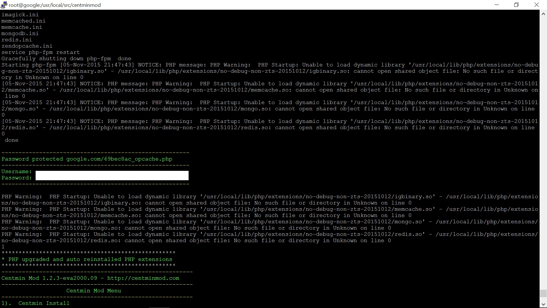

    I wish I could ignore these though. It doesn't seem to like
    igbinary.so
    memcache.so
    mongo.so
    redis.so
    I've attached the screenshot and also the logs.
    These appear to be only warnings, so I'm not yet sure if the install completed and started OR I have an issue.

    php -v
    php -i
    ^ Both work so they're only warnings. Things for me to track down. lol
