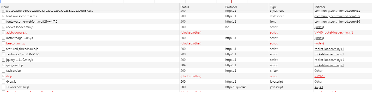

    The same situation is on this forum
    https://community.centminmod.com
    Please have a look HTTP/1.1 not H2:
    @eva2000 is is a bug?

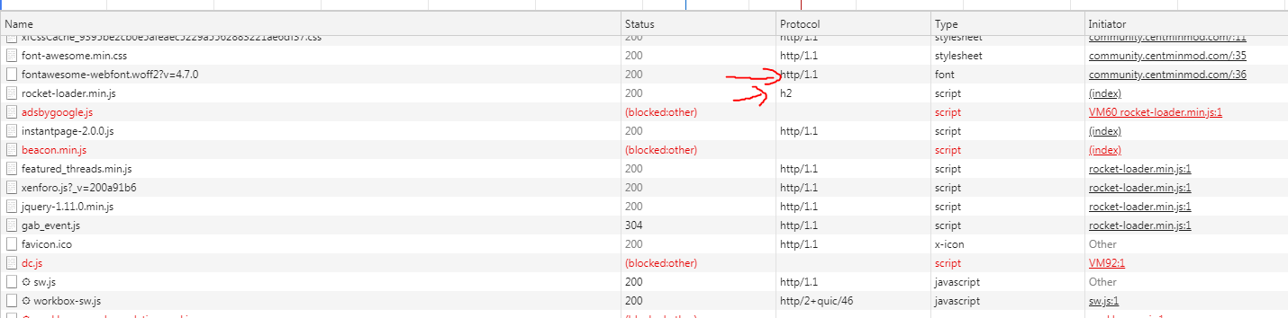

    Please have a look that other resources are h2.
    H2 like https://ajax.cloudflare.com/cdn-cgi/scripts/7089c43e/cloudflare-static/rocket-loader.min.js
    Only HTTP/1.1 not H2.

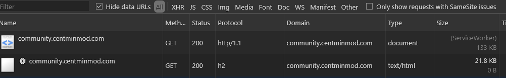

    For Chome devtools reported, Centmin Mod forum uses Service Worker caching so it speaks HTTP/1.1 between your web browser and the Service Worker so normal. See Added Forum PWA Mode For Page Speed Improvements.
    Network dev tools 1st request is Service worker pre-caching talking HTTP/1.1 between the web browser and Service worker installed within the visitor's browser and then a network request for revalidation check between Service worker and Cloudflare protected origin via HTTP/2

    I have used the same browser now.
    I have the same situation like for the forum.
    All resources from my domain are http1.1 only 3rd party are h2.

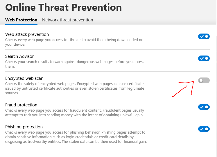

    George I have check community.centminmod.com on my VPS with windows and there it show h2 for community.centminmod.com.
    It is very weird my maybe my Bitdefender block it.
    But why it do not block other connections and 3rd party connections are as H2?
    46,650
    10,590
    +16,435
    7:58 PM
    Bitdefender is MITM your HTTPS requests Talk:Bitdefender - Wikipedia"MITM_attack"
    https://www.zdnet.com/article/googl...to-av-and-security-firms-stop-trashing-https/
    You'd have to turn of Bitdefender's MITM settings

    Ok I have found the problem. Bidefender block most of SSL.
    Possible non Letsencrypt SSL was OK.
    I have turned off this and now all links are as H2.
    It is very weird problem. Possible slow down webistes for Bitdefender users.
  17. adamus007p
    adamus007p Member
    254
    Feb 8, 2019
    +28
    11:58 AM
    I have double check everything and it is OK. On every VPS is H2.
    I am sorry for false positive alert.
    This Bitdefender is ..... I will not end.
    46,650
    10,590
    +16,435
    7:58 PM
    Yeah some anti-virus software are doing bad things by intercepting HTTPS requests via MITM.
