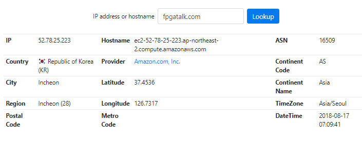

    CSF Firewall is automatically installed/configured out of box so that shouldn't be the issue. Who's your web host or web host plan used ? Some web hosts have their own firewall layer in front of the server which maybe enabled by default or optionally enabled by end user i.e. AWS EC2, Google Cloud compute etc. So the port 80 and 443 would need opening on those front end layer firewalls separate from Centmin Mod CSF Firewall.
    You letsencrypt ssl cert issuance failed domain webroot file based verification as seems your domain points to an Amazon AWS EC2 IP so I assume you are using EC2. So with Amazon EC2 servers, you need to configure EC2 firewall security groups Authorizing Inbound Traffic for Your Linux Instances - Amazon Elastic Compute Cloud. You can see CSF Firewall's minimal open port configuration which you may need to replicate on AWS EC2 security group firewall for inbound connections at CSF - Centmin Mod LEMP stack CSF Firewall default port listing

    THis is a fresh install of Centos 7.5 from Digitalocean. I installed the beta centmin mod (ran centmin) and then immediately ran the tool.
    Did I mess up somewhere?
    43,131
    9,791
    +15,120
    4:44 AM
    Your domain name's DNS is pointing to an IP owned by Amazon EC2 network IP Location Finder | Detailed geolocation data and RESTful API - if that isn't your DigitalOcean IP address, then you have setup your domain's DNS A record incorrectly and needs updating to DigitalOcean's droplet server Ip addreess - probably why letsencrypt domain validation failed as it's connecting to wrong server IP

    I dont see how thats possible... Cloudflare is controlling my doman and its being forwarded by namecheap
  15. Kainzo
    Kainzo New Member
    12
    Aug 17, 2018
    +1
    12:44 PM
    Unsure
    My god... I just realized, I bought .org not .com...
    My bad.. lol
