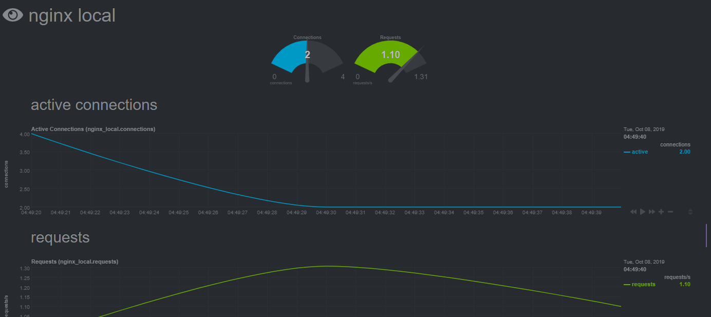

    @eva2000 Guess there is something wrong. I can't downgrade to 1.17.3, missing my nginx data in netdata, see Nginx - Nginx - Perfect install for netdata (system monitor) - Step by step
    I guess this has to do with the kernel
    uname  -r
    5.3.2-1.el7.elrepo.x86_64
    This because I have the same issue is on several servers
    You have mail

    Hi,
    The NGINX_HTTPPUSH='y' I only had on 01 server, and still no go on the video and netdata issue.
    As already told. Guess it is the kernel so went back to
    uname -r
    3.10.0-1062.1.2.el7.x86_64
    Changed NGINX_IOURING_PATCH='n'
    Now my nginx -V work fine. Might have a look into the new kernel. Only netdata still won't show up the nginx stats. Have to look at that part because it's in the nginx -V
    curl http://localhost/stub_status
    curl: (52) Empty reply from server
    I'm not longer @ DO where I also had netdata after reading a nice tweet.
    You can find it on Google, just Google "How x just killed our company x. A long thread for a very sad story"
    Had many issues with them also.

    FYI, unless you modified Centmin Mod Nginx's default, the Nginx status stats are at /nginx_status
    curl -s localhost/nginx_status
    Active connections: 1
    server accepts handled requests
     30 30 32
    Reading: 0 Writing: 1 Waiting: 0

    It was working on all servers, suddenly stopped. Noticed on a new server that the nginx_status was already inside the default config. So NO, no need to change it.
  11. EckyBrazzz
    699
    139
    +258
    11:34 AM
    1.17.x Cluster
    10.3.x Cluster & Redis
    Yeap, have to update the manual about netdata, made a little mistake there.
    Active connections: 2
     7684 7684 50660
    Reading: 0 Writing: 1 Waiting: 1
