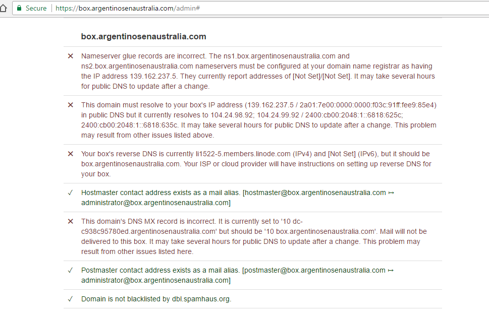

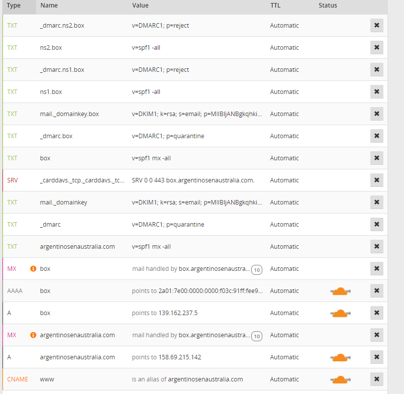

    I currently have my domain pointed to 158.69.215.142 (vps1) which is the server where I want to store the website. However, I'd like to send emails through 158.69.215.142 (vps2) where I installed mail-in-a-box.
    This is what I've set in CF:
    However, I'm unable to pass all Mail-in-a-box checks:
    Could you please let me know if I'm doing anything wrong?

    Please remove your ip address (plain text). As it could be scraped by spambots.
    It seems that your domain has HTTP proxy (CDN) and DNS enabled.
    So not only your DNS but also traffic will go trough Cloudflare.
    You need to use the DNS feature only, in case of Cloudflare, otherwise your traffic is proxy-ed and can't reach your mail server. Also don't forget to setup Rdns (reverse DNS) at Linode, otherwise your mail will be marked as spam.
    P.s. you will never pass all checks because you are using external DNS services.
    Please keep that in mind.
    Hopefully this will help.

  13. elargento
    elargento Member
    348
    Jan 4, 2016
    +43
    6:08 AM
    great, thank you! it worked :)
