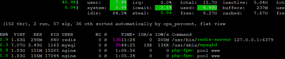

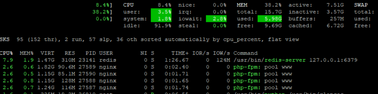

    Hello, it is recently that I use VM I have always used dedicated.
    Done because I see the% of iowait a little strange (10 15% ssd disks) using top2 (glances)
    Also I can not understand (as photos) what is IOW/S related to each process and why report so high redis?

    glances has overhead itself when running to verify try using sar -d and pidstat -d outlined in 20 Useful Commands of 'Sysstat' Utilities (mpstat, pidstat, iostat and sar) for Linux Performance Monitoring to double check
    i.e. check process id for redis-server for 10 runs at 1 sec interval for disk stats + cpu and memory
    pidstat -durh -p $(pidof redis-server) 1 10
    but yes redis by default has disk backed persistence as redis server isn't just used for caching but for persistent storage like mysql as well. See these threads
    in redis.conf

    Also what are you using redis for ? just caching or storing too ?

    Thanks for the reply
    on this vm I use it for wordpress caching (nginx level) and object cache.
    here is the result of pidstat, in a time with low traffic

    looks good at low traffic what does glances report ?
  6. upgrade81
    266
    16
    Sep 5, 2016
    Italy
    +27
    2:06 PM
    1.17
    10.3
    there is half of the traffic compared to the previous screenshots
